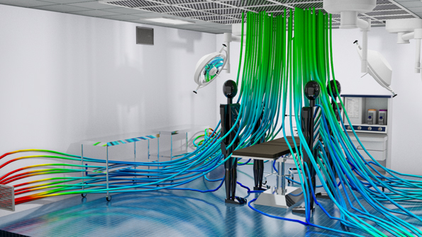

A CFD simulation of a Cleansuite installation in an operating room shows laminar air flowing from diffusers in the ceiling, down and away from the patient, and out vents near the floor.

To improve OR cleanliness, Huntair borrowed an idea from the semiconductor and drug industries — to use laminar airflow directed down and away from the critical area. In hospitals, that meant the operating table. Laminar flow is uniform in direction and velocity and directs particles and contaminants along a predictable path. If airflow is turbulent, contaminants float undirected, eliminating the ability for planners to predict where they will land.
In a typical operating room, turbulent air can swirl contaminants from equipment, staff, or the patient himself around the OR and the sterile surgical area, as this CFD simulations of an OR shows.

The simulation and CFD showed that industry-standard diffusers used in ORs set up several different airflows that interfered with each other or created gaps in the coverage, all of which led to turbulence and recirculation. The diffusers also caused air temperatures to vary by as much as 10°F.
The CFD analysis led the team to conclude that the best approach would be a holistic one that addressed the entire OR. That’s how the final design, dubbed Cleansuite, came to include a ceiling-hung plenum, HEPA filters, and a single diffuser design — all in one modular unit that could be custom-fit to specific ORs. But it would also include electrical connections and outlets, a delivery system for a variety of medical gases, UL-listed lighting fixtures, as well as mounts for booms strong enough to hold heavy surgical lights, equipment, and monitors. And it all attaches via a structural interface that gets bolted to the hospital’s structural framework. They even sized the modular units so they would fit through a standard 3-ft-wide doorway.
