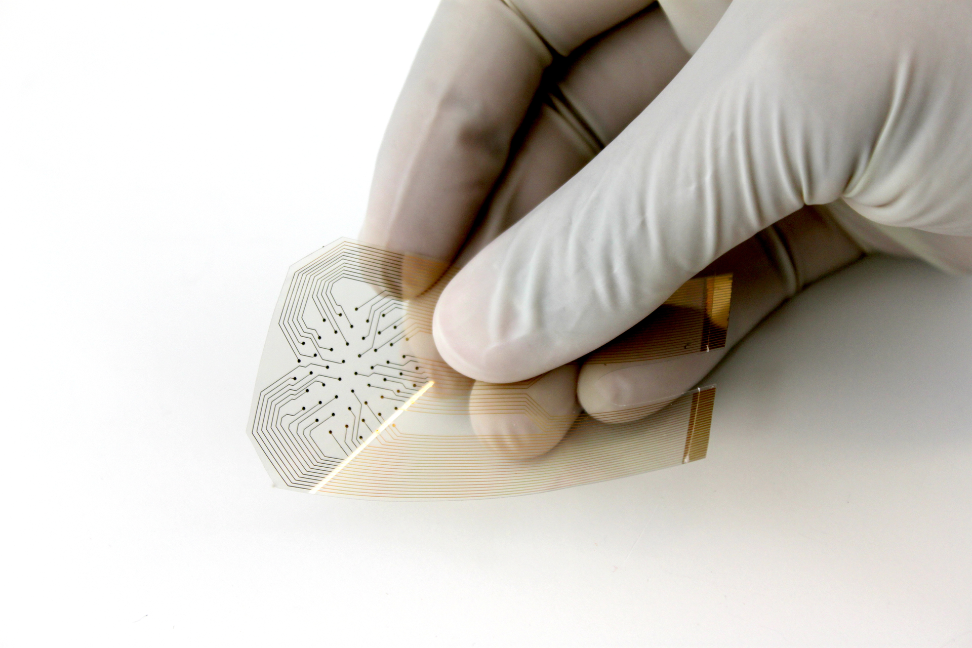

The bandage consists of an array of electrodes printed on a flexible film. A low current sent between the electrodes at various frequencies spreads into the surrounding skin tissues. The bandage then detects and maps the impedance spectrum of the underlying issue.
Healthy skin-cell membranes are relatively impermeable and act as insulators around cells’ conductive contents. This makes the cells act much like capacitors. But when pressure limits the local blood supply, cell membranes break down and let electrical signals leak through, much like a resistor. Impedance spectroscopy detects these changes, which correlate with bed sore formation and can be detected in the early stages of bed-sore formation.
