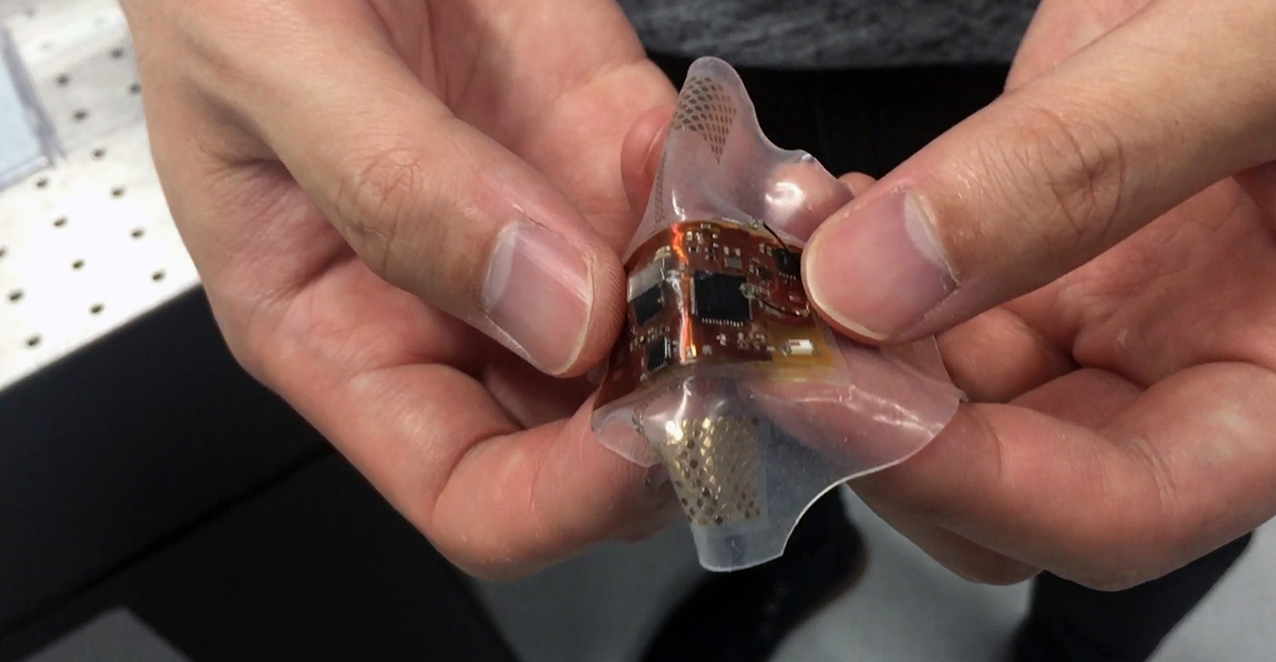

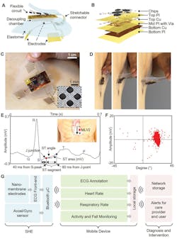

The major structural component of the stretchable hybrid electronic system (SHE) is a cast mixture of elastomers with extremely low moduli, so the device is naturally adhesive to the skin and compliant for stretching and bending (Fig. 1). This eliminates the need for conductive gels and adhesives, which add complicating issues of applying the patch and user comfort.
1. Overview of the SHE and data management showing: main structural components and their assembly for SHE (a); blow‐up image detailing the layer information of the flexible circuit (b); photo of an SHE showing the soft and adhesive property for direct lamination with the skin without the use of adhesives (c); side view of delamination sequence of the ultra-thin device with no negative effects to the skin (d); detailed inspection of ECG acquired by the SHE in (c) and identification of PQRST waves, J‐point, and ST‐segment angle (inset diagram describes the position of SHE (red dot) and polarity of the two measurement electrodes) (e); scatter plot (f) showing the angle and amplitude distribution of ST‐segments of the ECG data in (e); flow‐chart illustration of a real‐time, smart, and ambulatory health monitoring, enabled by the SHE (g). (Source: Georgia Tech)
The extremely thin Au/PI electrodes (1.2 µm) are arranged in a stretchable mesh layout that conforms to the complex skin surface structures, yet can easily deform along with the dynamic movements of the skin tissue. The integrated-circuit components are isolated by the elastomer and fully enclosed, and are powered by a lithium-based battery. The 500-µm-thick, low-modulus elastomer layer preserves the thin‐film properties of the nanomembrane Au electrodes and allows for the stable monitoring of the skin potentials.

The set of three nanomembrane gold electrodes that contact the skin are photolithographically patterned into a network of repeating units of circular islands bridged with meander lines, for both stretchability and conformal contact to the skin.
The oil chamber seems like an odd part of the structure, but the need for it arose as a result of real-word issues and was deemed a practical solution. The researchers found that portions of the SHE soldered with the surface-mount chips would disrupt the compliant-device mechanics, leading to poor device and electrode adhesion. To overcome this, they added a thin oil-filled decoupling chamber under the circuit’s footprint to separate the mechanics between the electrodes and electronics. Vegetable oil was injected in the chamber using a micropipette and sealed with elastomer.

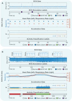

The device was tested both for durability and performance. For the former, numerous tests were run using various test-fixture arrangements, such as applying the patch to a soft cylinder (simulating an arm) and rolling it across a flat surface to physically stress the elastomers and circuitry. Field tests were conducted using test subjects. The raw physiological data was transmitted via Bluetooth to the connected mobile Android device, where it was processed through convolutional neural network (CNN)-based deep-learning algorithms to determine ECG, heart rate, respiration rate, and overall activity (Fig. 4).
4. In vivo, real‐time validation of the designed algorithms with human subjects including a real‐time, ambulatory monitoring of ECG and motion activity with a SHE on a human subject. At both idle (a) and active movements (b) of a subject, the device clearly detects VEB in the annotation model, with a variety of activities including walking, climbing stairs, and running (b). The four zoom‐in plots in (b) show a detailed two-second window of ECG waveforms from corresponding activity. (Source: Georgia Tech)
