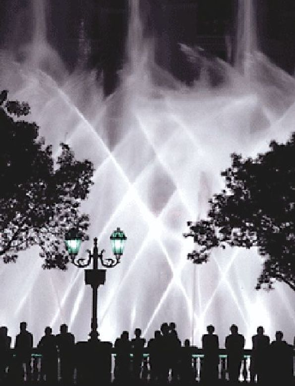

Water specialists at WET Design, L.A., designed and patented a variation on the water lariat: the Oarsman. It's a self-contained robotic nozzle that includes a variable-frequency drive, pump, and lights. "Operators or a preprogrammed computer feed it electricity and control data, and it responds by positioning the nozzle in the X-Y axis and adjusting its flow rate for just the right stream height," says Tony Freitas, manager of architecture and facility engineering at WET Design. (WET, by the way, stands for Water Entertainment Technology.) "An Oarsman takes water right out of the fountain and pumps it out at up to 120 gpm. There are no water pipes connected to an Oarsman."
Oarsmen were invented for WET's piece de resistance, the eight-acre fountain in front of the Bellagio Hotel and Casino in Las Vegas. They needed a good-sized jet that could gracefully wave back and forth, smoothly change height, spin, and do it all in time to music. The Bellagio fountain originally had 214 Oarsmen installed, but after some on-site testing and fine-tuning, the WET team removed about a dozen.
Before WET could use the Oarsman, however, it had to develop a ground fault circuit interrupter (GFCI) that could handle Oarman's unusual characteristics. "We were using 208-V, three-phase motors, which are not your typical motors, variable-frequency drives for the pump, and stepper motors for moving the nozzles. All this generates noise and harmonics on the line that conventional GFCI see as current leakage," points out Freitas. "But we didn't try to get a variance or get around the regulations, we just went ahead and designed a GFCI."
WET also has vertical jets called Shooters, and they're used at Bellagio, but they differ from those found in other designers' fountains. There's actually a whole line of Shooters that use the same principles, ranging from NanoShooters to Supershooters.
Shooters consist of a receiver for compressed air, a cylindrical holding tank, and some clever valving. In operation, a valve on the holding tank opens, fills with water from the fountain, and closes. A pipe sends compressed air from an equipment room "onshore" to the receiver where it is stored. When the Shooter is "fired," a valve opens, sending compressed air rushing into the holding tank where it becomes an expanding bubble forcing water out of the tank through a nozzle. "So Shooters can't create jets that last all day," explains Freitas. "They're for instantaneous shots. And the bigger the Shooter, the longer it takes to refill the holding tank, so the longer the lag between consecutive shots." Operators control jet height by adjusting the volume of pressurized air released into the holding tank.

Another Shooter in the arsenal, the MiniShooter, sends water up to 125 ft into the sky. Bellagio has 798 of them. SuperShooters, the top of the line, use holding tanks that stand 12-ft tall, 1 ft in diameter, and hold about 75 gallons. Their air is stored at 200 psi in 60-gallon receivers. When it is released into the tank, the pressure launches a plume 245 ft high through a 2.5-in. nozzle. Bellagio boasts 192 SuperShooters.
"Not all the water goes to 245 ft," points out Freitas. "When we tested the SuperShooters, all the water did go to the apex. But some of it was already coming down, passing through itself, as the last of the water was still going up. We discovered it looks better if pressure declines during the shot. So the top goes to 245 ft and the bottom only goes to 50 ft, making it look more like a standing column of water."
Another problem with SuperShooters involved the huge pressure drop across the air-control valve. It was forming ice in the valve body. "To cure that, we put a pressure plate a few feet upstream to control the pressure drop. The plate drops the pressure in half, then pressure drops again at the nozzle. Fortunately, it doesn't affect the display much."
Another possible solution, he adds, would be to add an air-drying subsystem to the fountain. "Bellagio has such a big air system, we decided not to. But if we were doing it again, we might include dryers."
Shooters and other devices that rely more on air pressure than water pumps save money, energy, and installation costs according to Freitas. "It would take a 300-hp pump to create one 245-ft-high jet, and there are almost 200 SuperShooters at Bellagio. You would need 60,000-hp worth of pumps and the whole system would have to be sized as if it always worked at maximum load. Compressed air, on the other hand, can be stored, letting you size the system for the average load. We run the compressors continuously and bank air for peak moments. So our compressors, standard rotary screw models, occupy one-tenth the space pumps would. And the pipes sending compressed air out to the various Shooters can be much smaller than the pipes that would be needed to carry incompressible water for equivalent jets."
