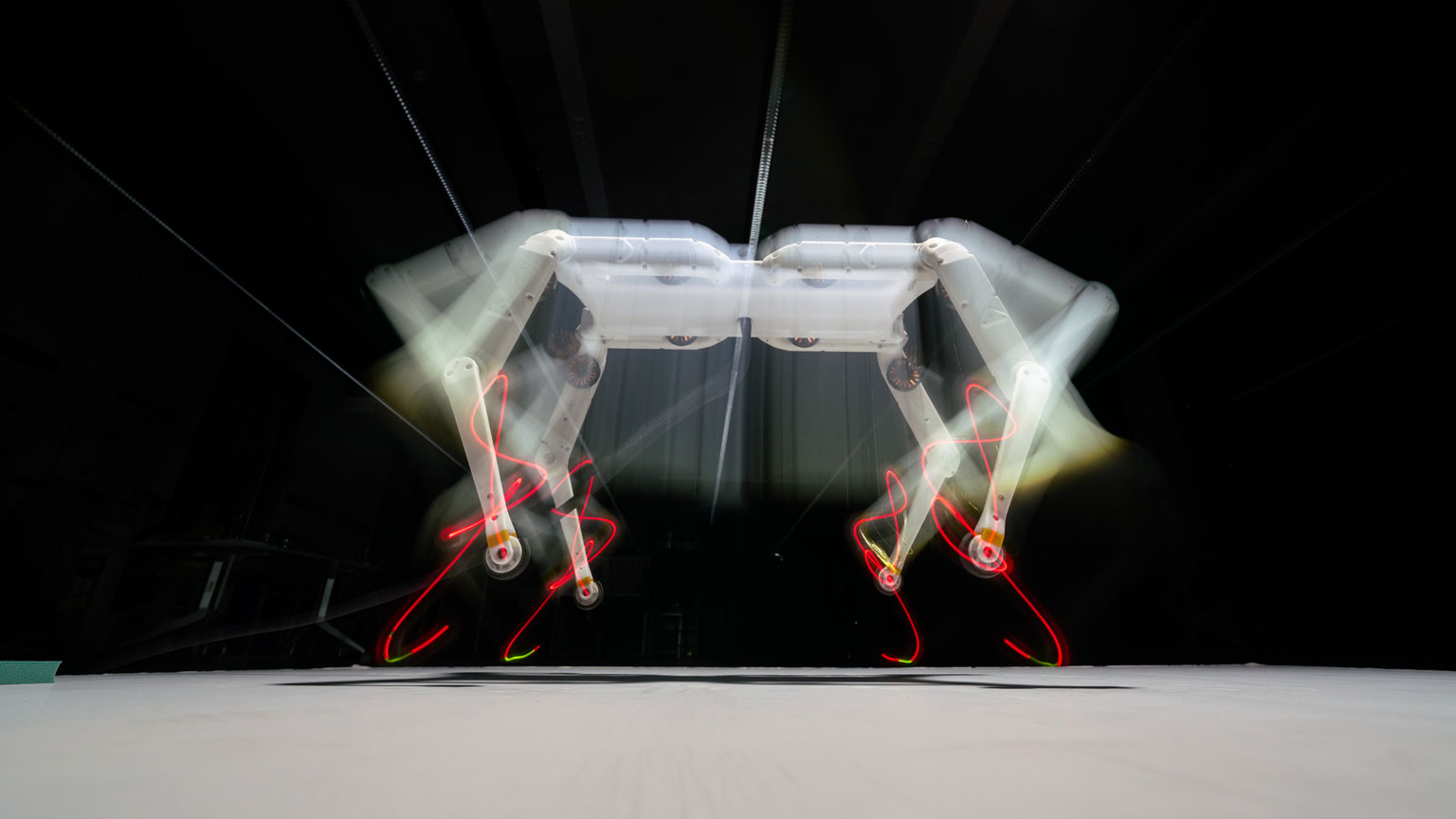

A team of researchers at New York University’s Tandon School of Engineering and the Max Planck Institute for Intelligent Systems in Tübingen and Stuttgart, Germany, designed a quadruped robot called Solo 8. The robot, an open-source design project, is named after its eight torque motor-controlled joints.
“We started to discuss motors that are used for drones that are very powerful and very small,” said Ludovic Righetti, associate professor of electrical and computer engineering and mechanical and aerospace engineering at NYU Tandon. “The other thing about the motors is that they’re cheap.”

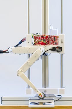

The project started out with a single leg, but after the robot’s power-to-size ratio exceeded expectations, the quadruped was created.
Weighing 2.2 kilograms (4.85 lb), the robot is 24 cm tall when standing and can jump 65 cm high. When Solo falls, it can configure its legs into the standing position again. Videos of the robot’s other movements can be found online. The purpose of the project, according to Righetti, was research.
