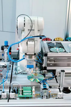

Grippers are available to suit just about any application, such as this parallel design used to handle DVDs.

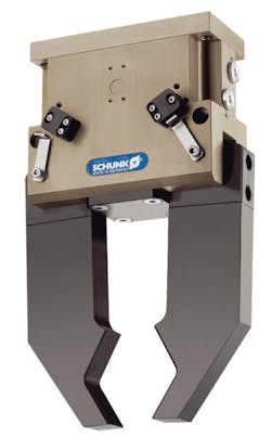

Hayes explains that the two-jaw parallel gripper is the most versatile design and is able to handle a large percentage of applications.
Two-jaw angular grippers can handle myriad part shapes and sizes.
“The reason why the two-jaw parallel design is the most commonly used is because it can handle so many part shapes and sizes. It can also do the same job as the other two basic gripper types, the three-jaw gripper and the two-jaw angular,” says Hayes.

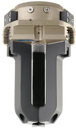

Three-jaw concentric grippers can only handle round parts axially, but are still quite practical, and used in 20% to 30% of all applications.
For example, the two-jaw parallel gripper can grip both round and square parts either radially (from the side) or axially (from the top). In contrast, a three-jaw concentric gripper can only handle round parts axially, like gripping a coffee cup from the top around its rim, or from the inside, pushing against its inner diameter.
That's not to say the three-jaw concentric design isn't useful. In fact, this gripper type is used in 20% to 30% of all applications. The next most common style — used in 10% to 20% of applications — is the two-jaw angular gripper. This design is best suited to grip round parts from the side, like using your thumb and index finger to pick up a coffee cup or other round object.

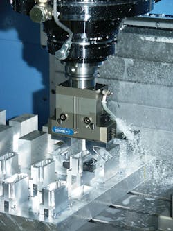

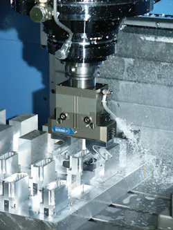

The PGN-plus-two-jaw parallel gripper from SCHUNK finds use in a machine tending application.
Regarding gripper actuation, about 80% of today's grippers are pneumatic. The reason? Grippers are mostly short-stroke components, so they don't consume a lot of air, according to Hayes. “Think about a long-stroke linear actuator,” Hayes says. “This component uses a lot of compressed air along its stroke length, so more of these designs are becoming electric. One day, we may see more servo-electric grippers in use, but today they're roughly two or three times as expensive as pneumatic designs.”
