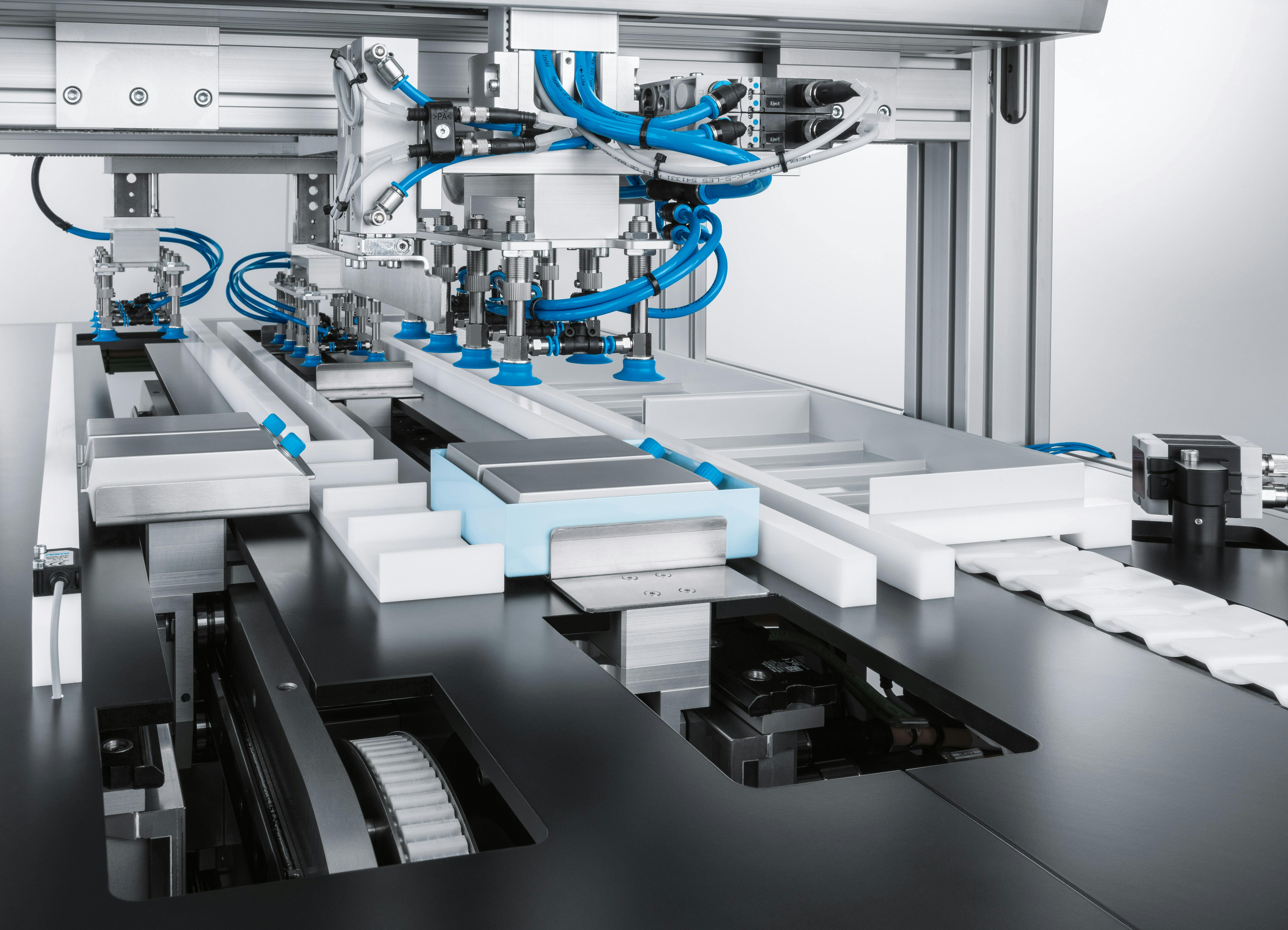

Courtesy Festo
Multi-head Festo Cartesian robot performs picking-and-placing actions.
