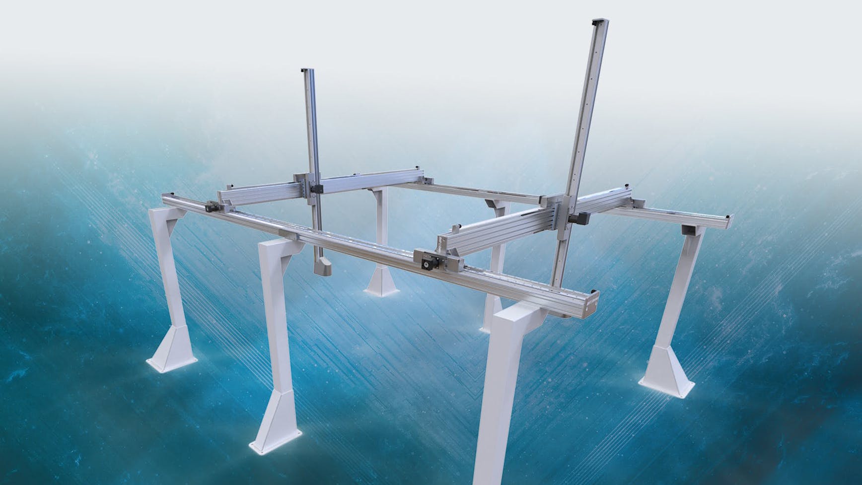

Multi-Axis ServoBelt Linear
The ServoBelt Linear Advantage
Both short- and long-length linear motion applications can benefit from an innovative linear-actuator design, which outperforms conventional belt-drive designs. The ServoBelt Linear actuator, for example, differs from conventional single-belt drives by utilizing two mating sets of polyurethane, steel-reinforced gear teeth that perfectly mesh together. This actuator design is topologically similar to a rack and pinion, and visually similar to an “omega” belt drive.
This actuator design allows the driving belt to remain under constant tension around the pinion, minimizing belt stretch and uniforming driveline stiffness throughout the entire motion travel length. For further precision and accuracy, a ServoBelt Linear actuator’s belt mesh is preloaded on either side of the pinion—ensuring zero backlash as the carriage moves in either direction. Zero backlash allows the use of linear encoders, which allows performance only matchable by linear motors.
These actuators are ideal in high-performance applications because of their precision, repeatability, cost and speed. They are ideal for applications in semiconductor manufacturing, packaging, aerospace assembly and other high-performance, high-precision industries.
