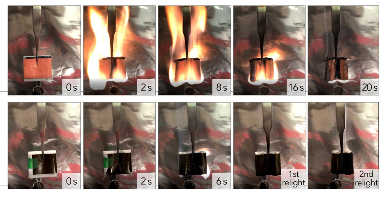

To combat the tendency of lithium batteries catching fire, the engineers tried adding fire retardants to the battery’s electrolyte (the flammable part). They found they could only add small amounts before the electrolyte became viscous and no longer conducted ions well.
To keep their new battery from going up in flames, the team embedded triphenyl phosphate, or TPP, in the polyamide as a fire retardant. Thus, the polyamide can resist fire and withstand the high temperatures associated with fast battery charging. The thin copper layer adds another level of protection against fire.
