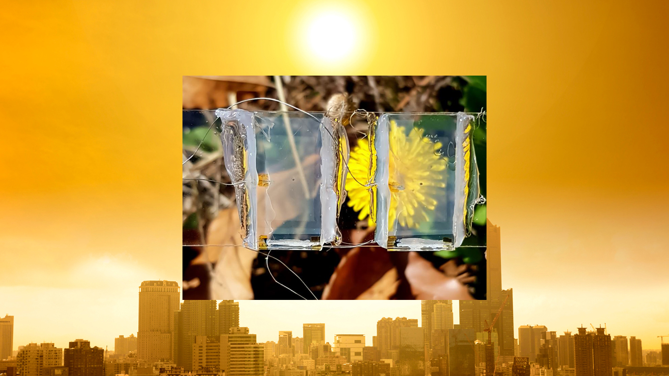

The team’s new solar cell is composed of a glass substrate and a metal oxide electrode, with thin layers of semiconductors (TiO2 first, then NiO) deposited on top. A final coating of silver nanowires serves as the cell’s other electrode.
Tests showed the cell had a power conversion efficiency of 2.1%, which the team says is good considering the cell uses only a small part of the light spectrum. The cell was also highly responsive and worked in low-light conditions. Furthermore, more than 57% of visible light gets transmitted through the cell layer, making it transparent. The researchers also showed that the cell can power a small motor.
