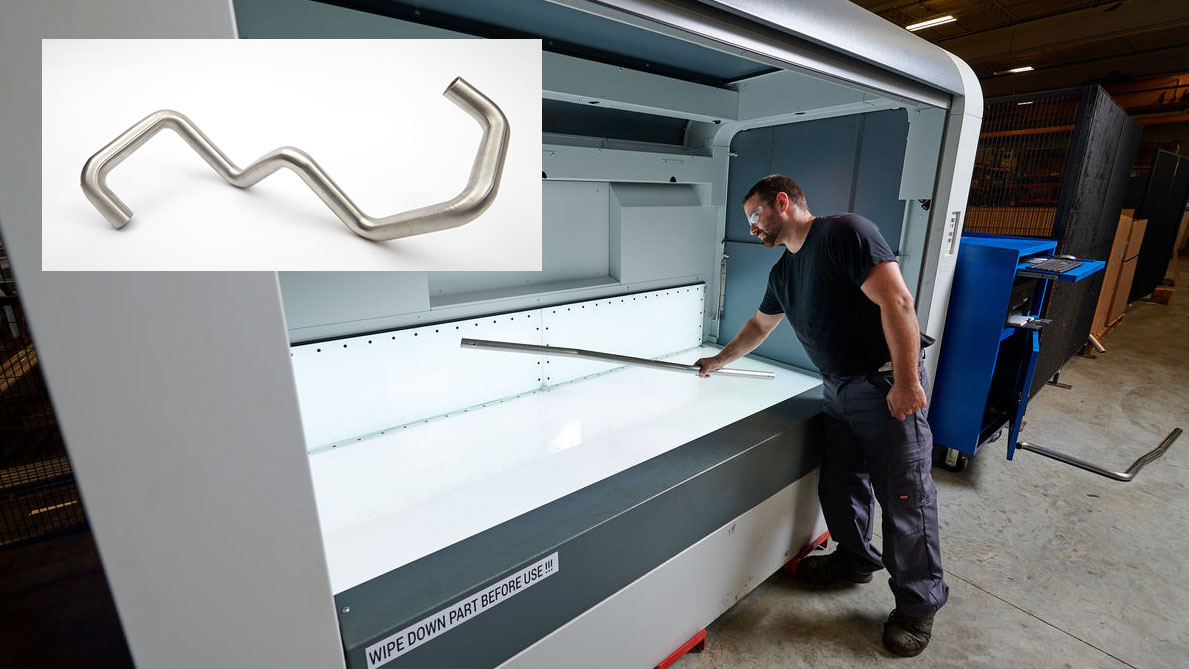

When it comes to bending pipe or tube, there are several methods used to achieve a quality, custom-formed part. The primary bending methods are compression bending, roll bending, freeform bending and mandrel bending (also called rotary draw bending), which is the most common method. Here is more detail about each of these techniques:
Compression Bending
This is a simple method of bending pipe or tube where the bend die stays stationary while a counter die bends or compresses the material around the stationary die. This method requires a bend die that is the size of the desired bend radius. The material is then formed around the bend die, without the use of a mandrel.
Roll Bending
Roll bending is typically used for large radius bending. In this process a piece of pipe or tube rotates through three rollers that are in a triangle configuration. The two outer rollers, usually stationary, cradle the bottom of the material while the inner roller, which is adjustable, presses on the top of the material. This method is ideal for large radius bends and is best suited for producing large, wide radius sweeps.
Freeform Bending
Freeform bending uses one set of tooling to bend variable or multiple radii. Normally pipe and tube bending requires a bend die, a clamp die, a pressure die and sometimes a wiper; with freeform bending, the material is continuously guided through the machine using one die that is the size of the pipe or tube being bent. Most any radius can be achieved using a single die set.
Rotary Draw or Mandrel Bending
One of the most precise methods, CNC rotary draw bending is probably the most tooling-oriented. As many as six tooling sets may be needed for a project, based on its size and scope. Of these, the three most important types are the bend die, pressure die and clamp die. Depending on the bend radius and wall thickness, a mandrel, wiper and collet may also be needed
Within this discipline is also multi-radius bending, which is commonly used for complex parts when one continuous pipe or tube requires two or more center line radii. It is a good fit for parts with a large centerline radius, where hard tooling may not be an option, or for complex parts that need to be formed in one complete cycle.

Center line radius. As a general rule, the tightest achievable center line radius is one times the pipe or tube diameter. Whenever possible, try to choose a center line radius of one-and-a-half times or greater than the tube diameter to save labor costs. Check your vendor’s tooling list to help you make this selection.
Wall thickness. When bending pipe or tube, the wall on the outside radius can thin up to 33%, depending on the radius and other factors. This is important to keep in mind if your application involves high pressure or flow, as a thicker wall may be necessary to achieve the desired results.
Straight length between bends. Typically, a straight dimension between bends should be two to three times the tube diameter, depending on the radius. Tubes with little or no straights between bends can be done using freeform bending, which in some cases may require additional tooling.
Tolerances. The industry standard is still considered to be ±1 deg. on bend angles. Tighter tolerances to 0.2 deg. can be achieved with laser spring back technology, if required by the application. Lineal tolerances are normally ±0.062 in. or tighter. The industry standard for ovality is 8% and can be lessened as needed.
Drawings. When submitting part drawings, it is important to include the pipe or tube specs, material type, center line radius, tolerances and any other details about the scope of the project. Be sure to include model files along with a PDF for easy viewing and analysis.
