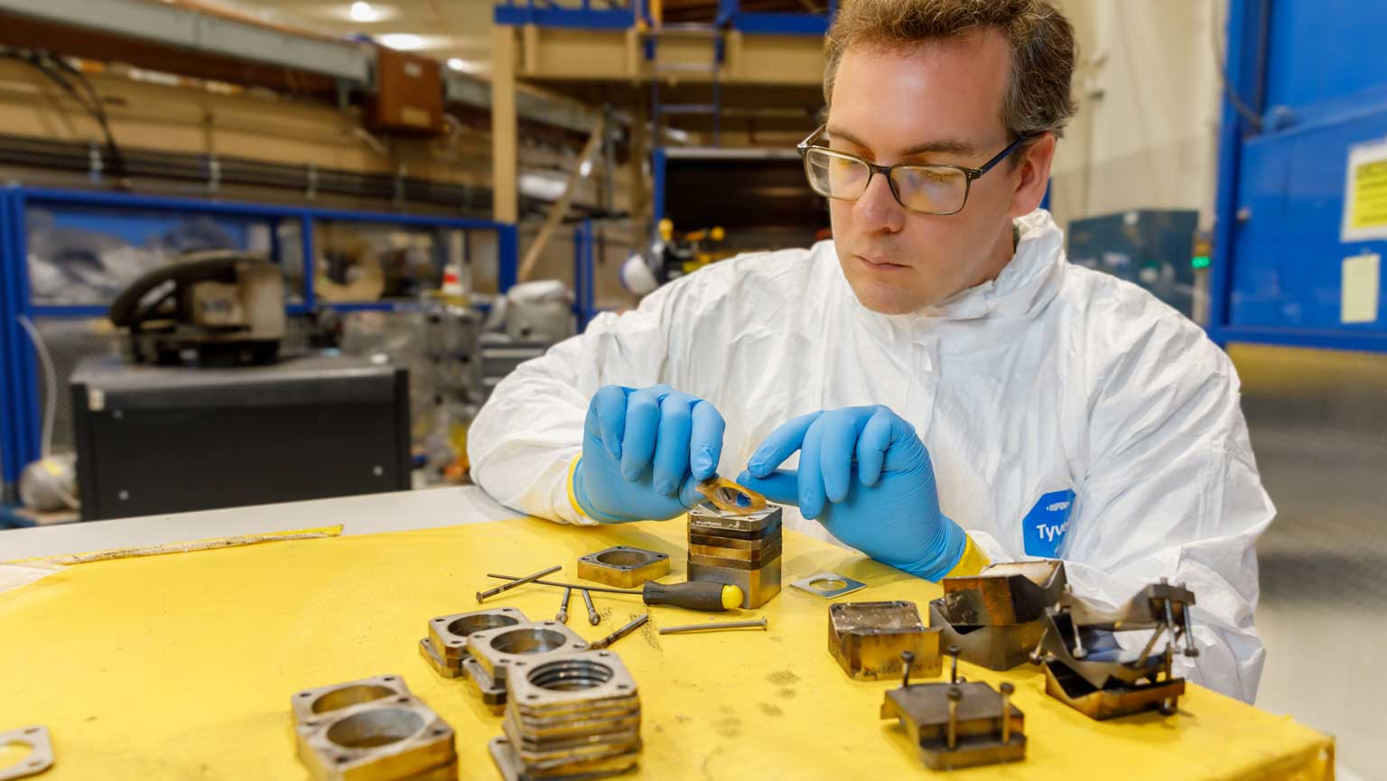

One aspect of that development project is devising better protection for the test objects, diagnostic equipment and drivers inside the new machine. The protection is needed because when the new X machine fires an X-ray pulse into a sample, much of the energy goes to creating shock waves and knocking debris loose. In fact, according to Sandia researchers, when X-rays are sent into samples, they create forces much like several sticks of dynamite exploding at close range.
“When we try to understand how matter such as metals and polymers interacts with X-rays, we want to know if debris is damaging our samples or changed its microstructure.” says Sandia physicist Chad McCoy. “Right now, we’re at the limit where we can protect sample materials, but more powerful testing machines will require better shielding.”
