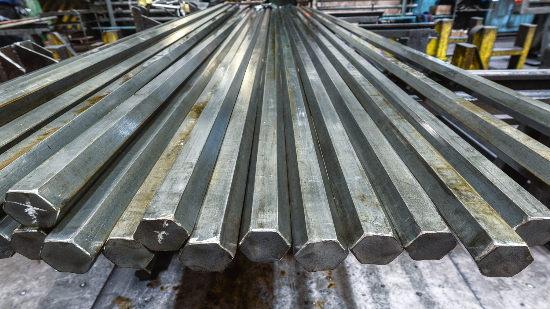

Bundle of hexagonal metal rods, hot rolled steel

Hot rolled steel is roll-pressed at temperatures over 1,700°F, which are above most steels’ re-crystallization temperatures. Hot pressing makes steel easier to form and work with.
RELATED: Tips for Making Shapes Out of Cold-Drawn Steel
Making hot rolled steel begins with a large, rectangular billet of steel. It gets heated, flattened into a sheet, and rolled up. While still white hot, it travels through a series of compression rollers that presses it into its finished dimensions.
The hot rolled steel is cooled after processing and it shrinks slightly as it cools. So there is little control over its final shape, making it less-than-ideal for precision applications. It is usually used only when specific dimensions aren’t crucial such as for railroad tracks and construction projects.
