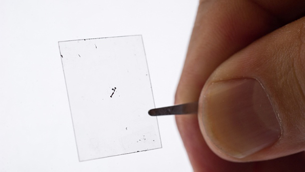

A super-slim generator has been constructed out of a few layers of molybdenum disulfide (MoS2) film--each only an atom thick--by engineers at the Georgia Institute of Technology teamed with researchers from Columbia Engineering. The MoS2 generator uses the piezoelectric effect to turn physical stresses and mechanical energy into electricity. This is unusual in that the material in bulk form exhibits no piezoelectric effect because it consists of layers arranged opposite to one another. To make the thin-film generator, the MoS2 had to have an odd number of layers. It also has to be flexed in a certain direction to get current flowing.
In the experiment, thin flakes of MoS2 were placed on a flexible plastic substrate. The team then placed metal electrodes on the flakes and used them to measure current flow and voltages. The team also noted that the voltage reversed sign when the substrate was flexed in the opposite direction, and it disappeared when they added another layer to give it an even number.
