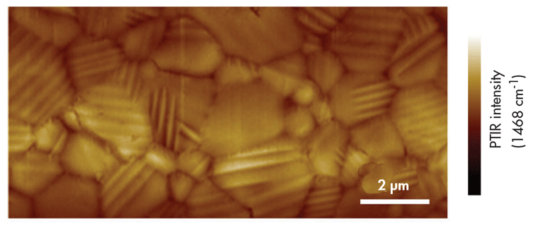

The researchers discovered that by bending the crystals, they could reliably move, create, or eliminate the ferroelastic grain boundaries—the borders between subdivided crystal regions having different orientations—thus enlarging or reducing the size of each domain. The bending also changed the relative fraction of domains pointing in different orientations.
In their study, the team found no evidence that OIPs were ferroelectric. In other words, they did not form domains where the separation of the center of positive and negative electric charges is aligned in different directions in the absence of an external electric field. This finding is significant because some researchers speculated that ferroelectricity might be why OIPs make promising candidates for solar cells.
The researchers created single whole crystals large enough to reveal ferroelastic domains, which appeared as striations with an optical microscope. They also studied OIPs consisting of polycrystalline thin films, which were examined using nanoscale techniques.
