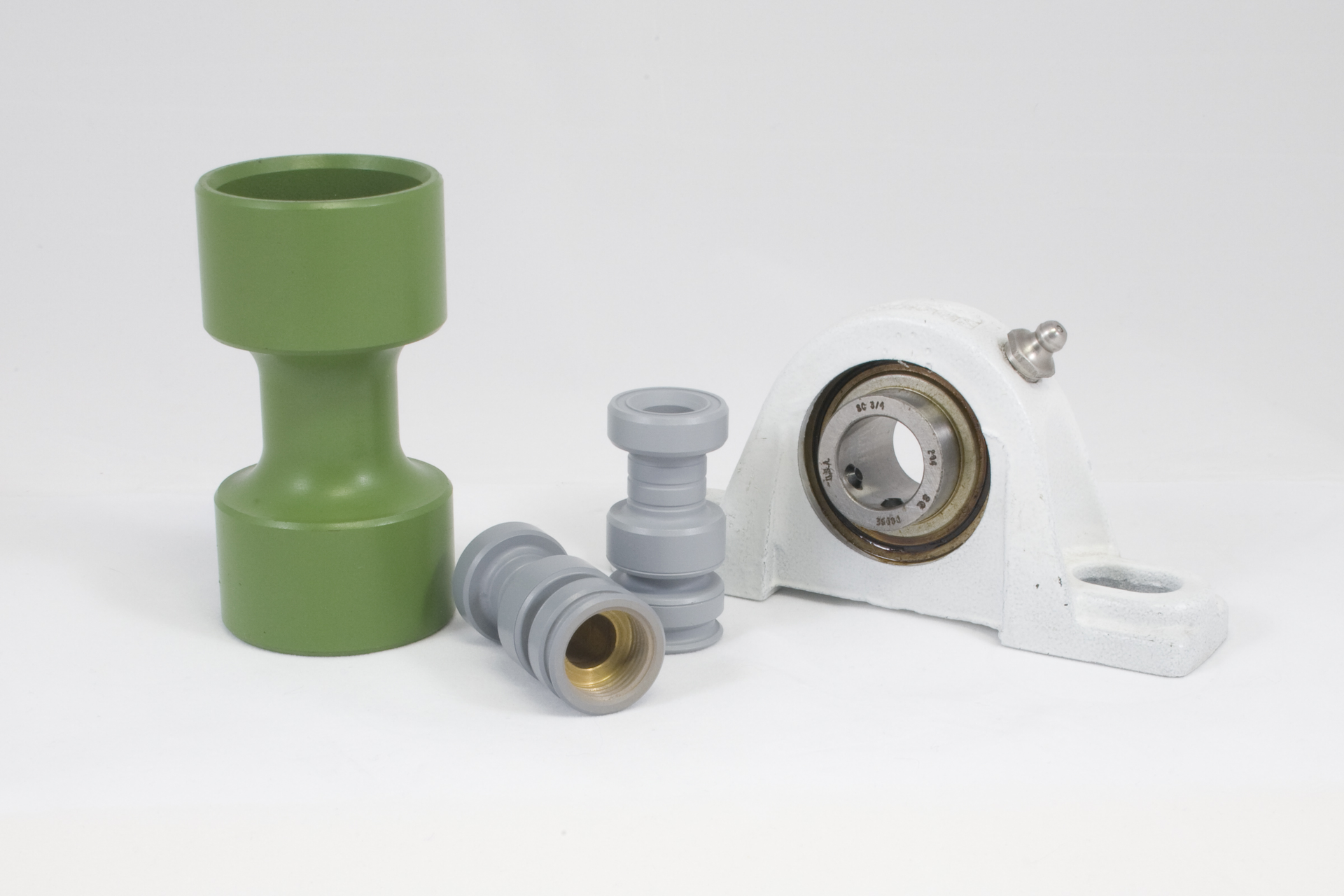

Known most commonly as a coating for non-stick pans, polytetrafluorethylene (PTFE) is offered in both liquid and powder forms. But its heat resistance, chemical inertness, excellent dielectric stability, and low coefficient of friction make it useful in other applications as well. This versatility applies to a variety of parts sizes and configurations manufactured from carbon steel, aluminum, stainless steel, alloys and other metals, as well as glass, fiberglass, some rubber, and plastic.
PTFE coatings can enhance performance and increase the value of products by creating functional surfaces that resolve issues such as friction, sticking, corrosion, noise, and abrasion.
