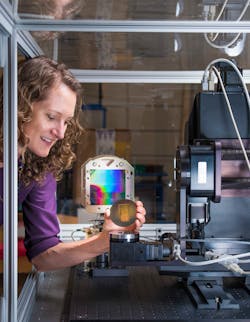

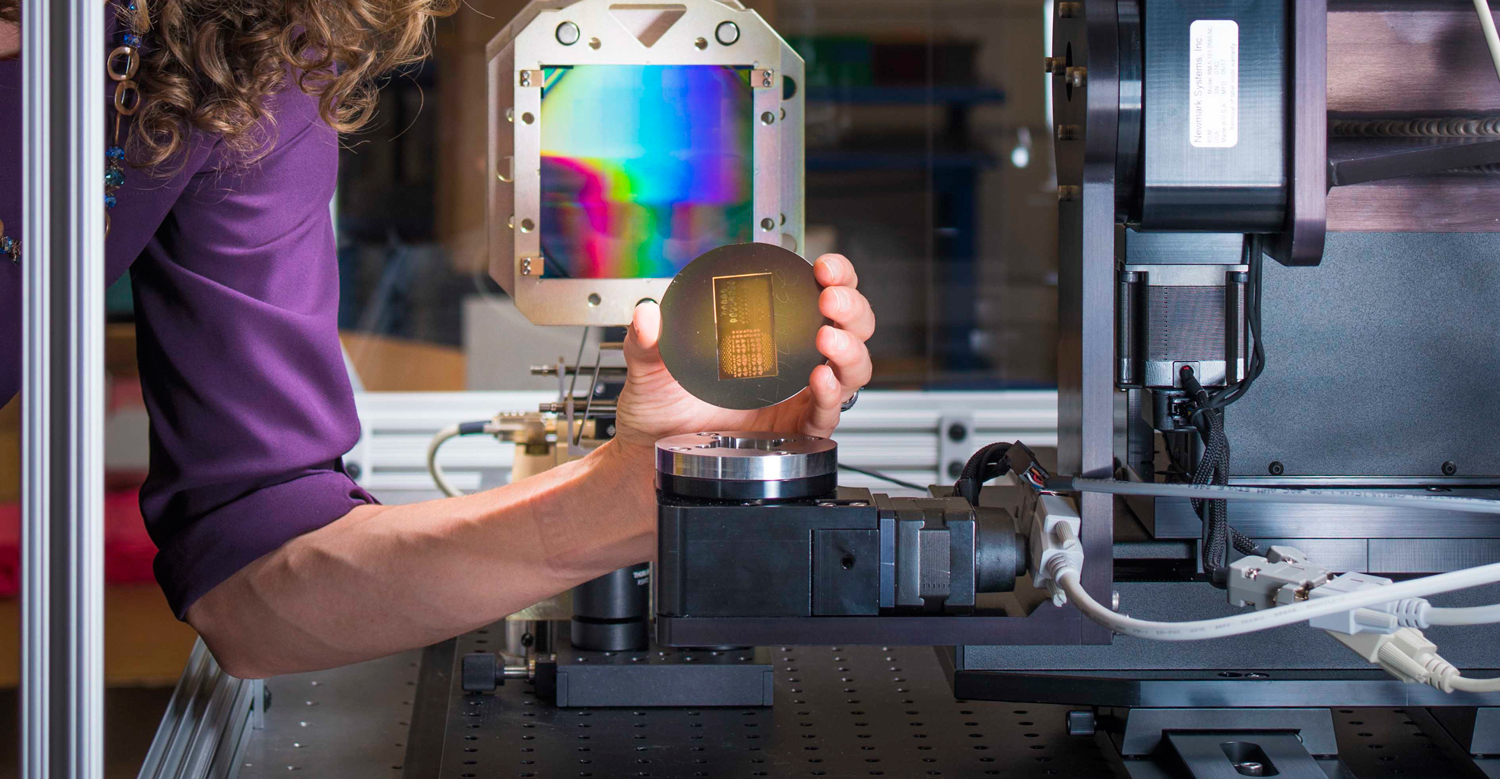

In the Sandi device, an optical grating breaks up the x-ray beam into thousands of smaller, very similar x-ray beams. This wave front of beams passes through the object and then through phase and analyzing gratings to an array of detectors. By analyzing the differences between various x-rays that travelled through the object, researchers can reconstruct the paths each took and how dense the various layers or areas are. This gives them a much better view inside the object.
