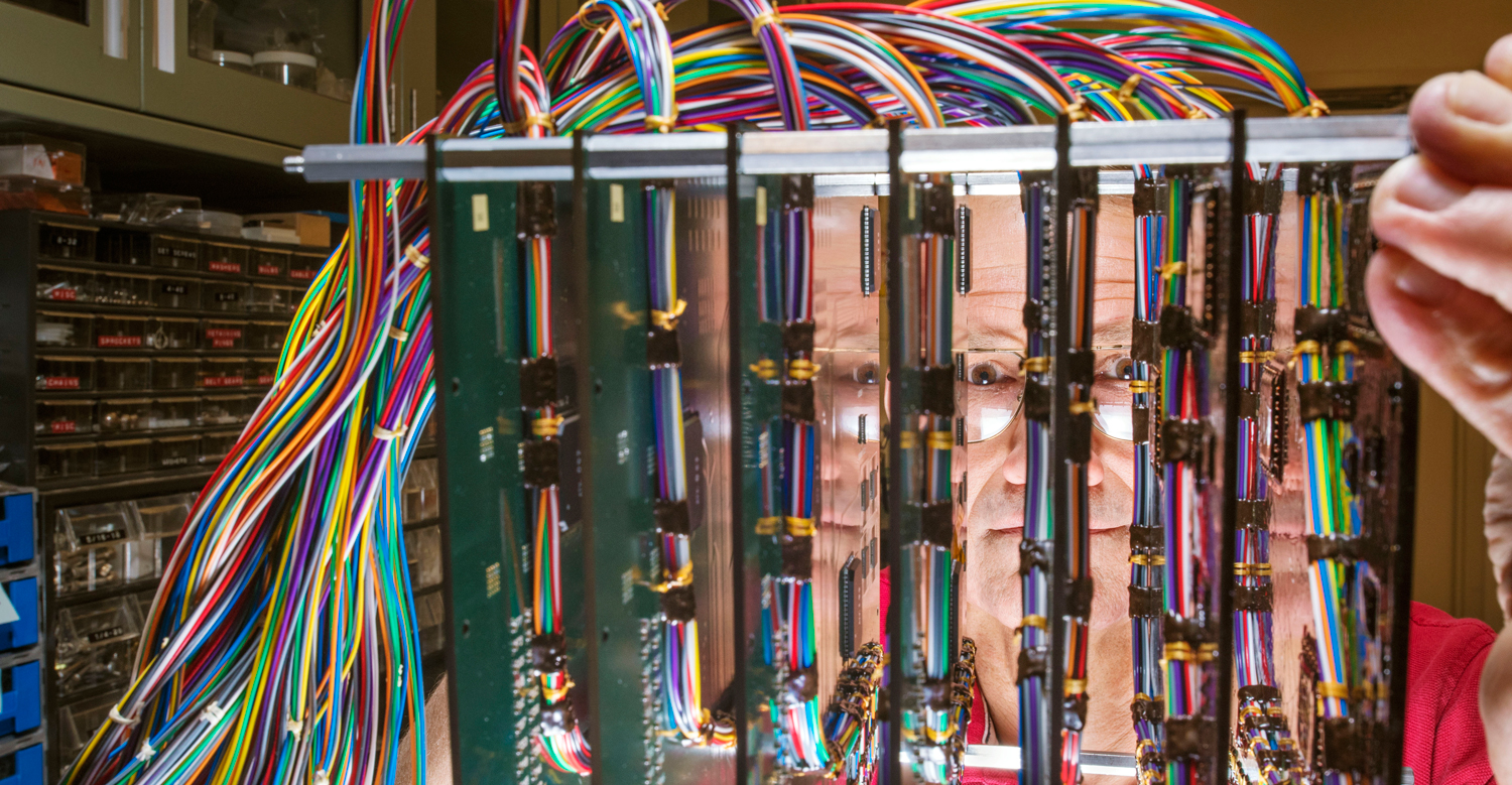

Anything with circuit boards requires countless solder joints, and miniaturized electronics have vastly increased the number present in printed wiring assemblies. Vianco notes two examples among a host of weapons’ wiring assemblies: one with more than 900 solder joints (400 on a single component), and the other with about 300 joints.
