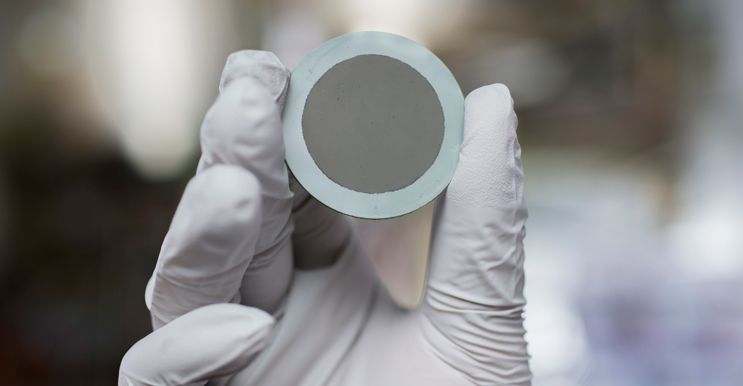

Fuel cells have a major bottleneck in their processing that prevents them from making more electricity: The chemical processes involving oxygen are too slow. To make up for this bottleneck, engineers specify pure hydrogen fuel, which reacts with the oxygen taken in from the air. But the costs of producing the hydrogen have been prohibitive. A new catalyst is a potential game-changer, however.
“It easily converts chemical fuel into electricity with high efficiency,” says Meilin Liu, who led the study into the catalyst and is a Regents’ Professor in Georgia Tech’s School of Material Science and Engineering. “It lets you use readily available fuels such as methane and natural gas or makes hydrogen fuel much more efficiently.”
The catalyst manages this feat by rushing oxygen through a fuel cell. “It makes the reactions more than eight times as fast as state-of-the-art materials doing the same thing now,” says Yu Chen, a postdoctoral research associate in Liu’s lab.

The new fuel cell catalyst, a coating only about two dozen nanometers thick, works in two phases. First, nanoparticles on top grab molecular oxygen from the air and tear it into single oxygen ions. Then, oxygen vacancies in the nanoparticle rapidly pass the oxygen ions to the second phase, a layer of oxygen vacancies which move the ions quickly to meet with ionic hydrogen to complete the chemical process that powers fuel cells.
