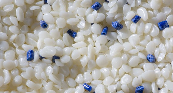

Some molders, including Protolabs, typically use a 3% salt-and-pepper colorant mix to give the final part a particular color.
Let's switch gears from additives that modify resins’ mechanical properties to ones that modify their cosmetic (e.g., colorants). Many molders offer a limited selection of colorants—Protolabs has about 45—that can be added to a base resin, usually at no additional charge. Thermoplastic base resins primarily consist of black, natural, and clear; colorants can be added to the latter two. Protolabs generally employ a 3% salt-and-pepper mix, with smaller percentages for transparent resins such as polycarbonate. The mix is not an exact color match. Even though a material can accept a particular colorant, part colors remain approximate. Some modelers will let you know or find out (using an online app) which colorants work with which materials.
