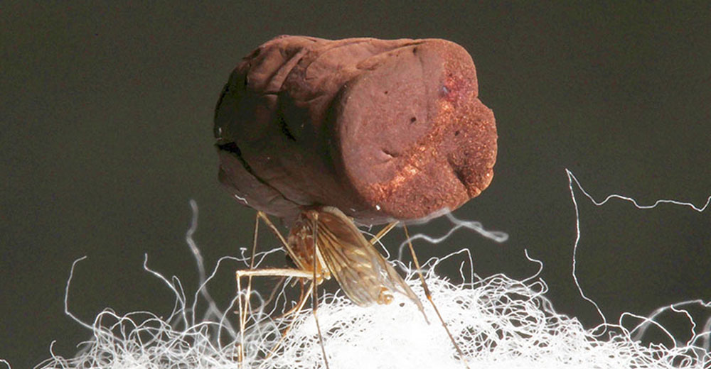

Gold, silver, and copper are heavy metals, but scientists can now make them nearly as light as air—and so tiny they can ride on a mosquito’s back.

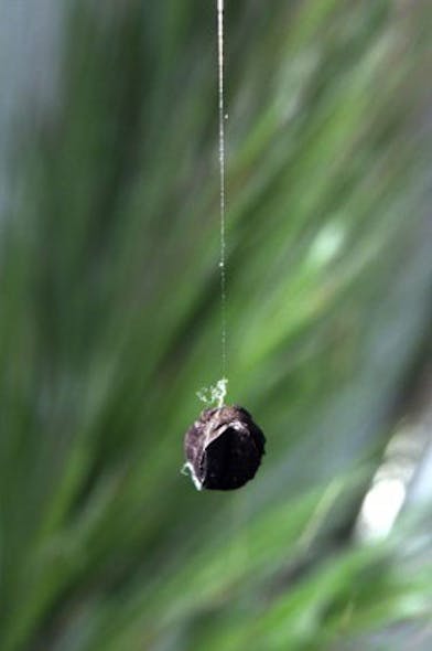

An ultra-low-density metal foam sample dangles from a strand of a spider’s web.
