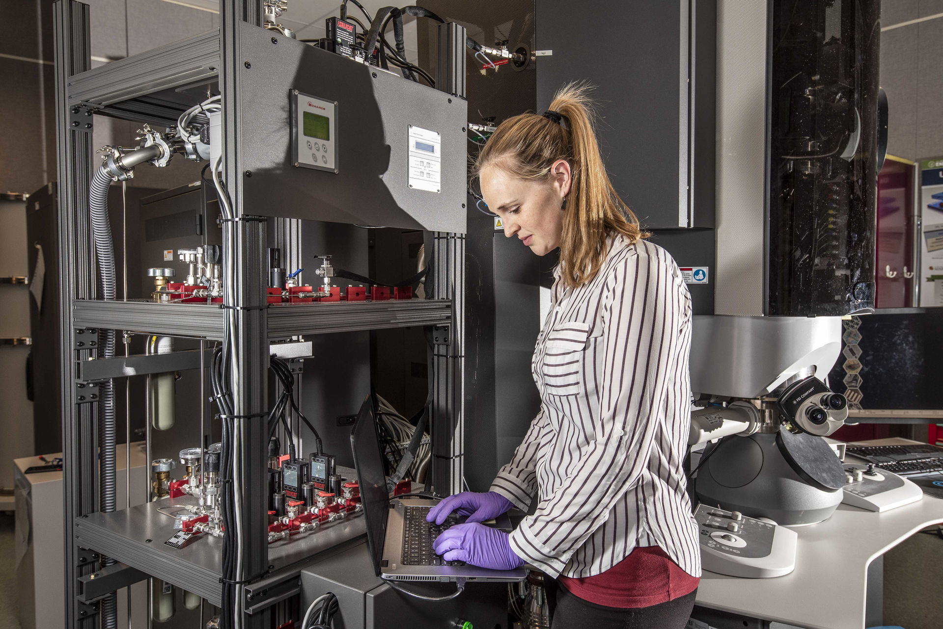

Sandia National Laboratories researcher Katherine Jungjohann was the principal investigator and lead microscopist for a study that pinpointed a major cause of corrosion in pipelines. Here she looks for corrosion with a new transmission electron microscope at the Sandia national Lab. The gas valves on the shelves at left produce different testing environments. (Courtesy: Randy Montoya)
