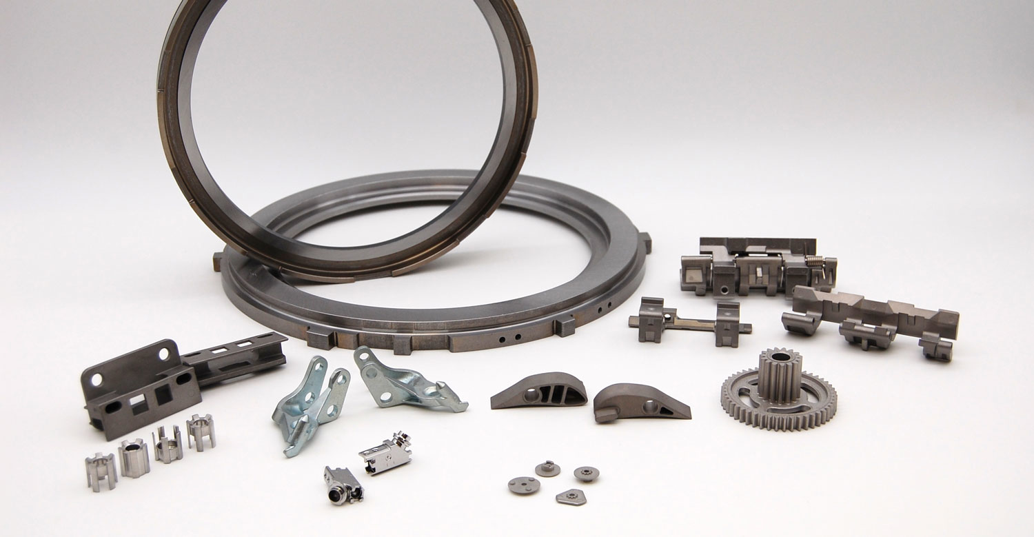

The basic PM process uses pressure and heat to form precision metal parts and shapes. Powder is compacted (at room temperature) in a rigid precision die at up to 50 tons per square inch into an engineered shape like a gear. Think of 50 compact cars stacked vertically and you have the pressure it takes to press the powder. After parts are compacted and ejected from the die, the part is fed slowly through a special controlled atmosphere furnace to bond particles together. They are metallurgically fused without melting, a phenomenon called “sintering.”
Other processes used to turn powders into finished shapes include cold and hot isostatic pressing (CIP/HIP), powder forging (PF), metal injection molding (MIM), direct powder rolling, gravity sintering, and metal additive manufacturing. Metal AM builds parts layer-by-layer without using a mold or die but by sintering or welding each individual particle of powder.
