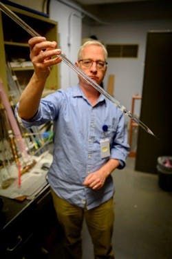

Colin Baker of the U.S. Naval Research Laboratory holds a silica glass rod (an optical preform) that has been infused with a holmium slurry and will be pulled into a doped optical fiber suitable for producing a more eye-friendly laser. (Courtesy: Jonathan Steffen)

To create the doped fiber, the researchers are using a large glass-working lathe in which the glass that will eventually become the fiber is cleaned with fluorine gases, molded with a blowtorch, and infused with the nano-particle mixture, what the scientists call a “nanoparticle slurry.” The result is a rare-earth-ion-doped, one-inch diameter glass rod, or “optical preform.”
Next, scientists use a fiber pulling device to soften the preform with a furnace and elongate it in a process akin to pulling taffy. The resulting optical fiber is about as thin as a human hair, which then gets spooled onto a nearby large spindle.
