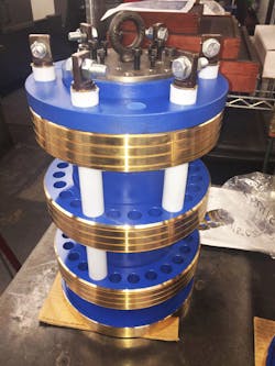

Morgan has also greatly increased the connection-rod diameters and improved the connection. This has been done by replacing the small-diameter threaded stud and nut with a larger flat surface and a bolted connection. The increased stud diameter and better connections greatly reduce the heat compared to the heat generated by higher resistance in small rods and poor connections in traditional slip rings.

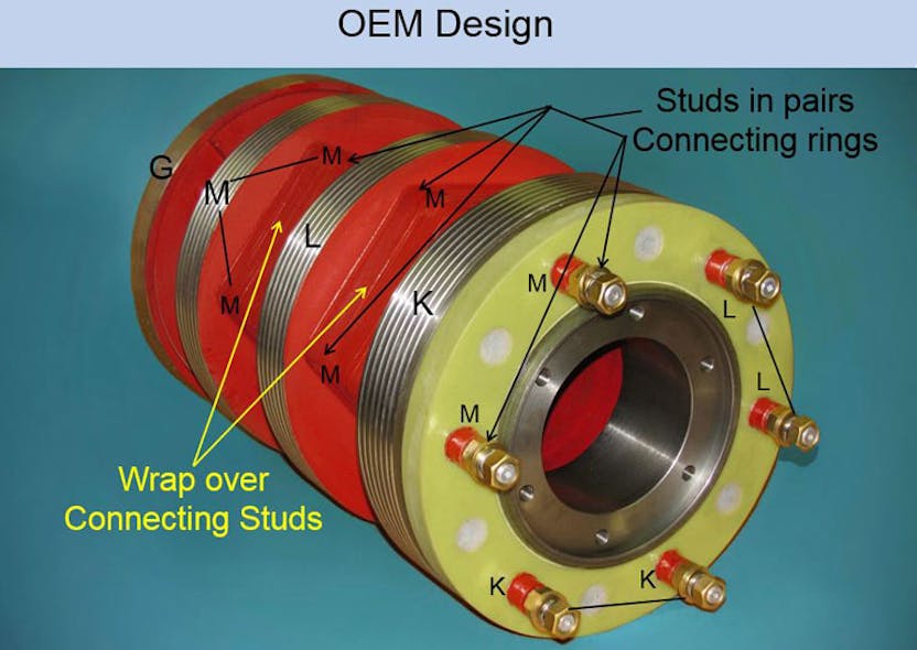

Many traditional slip rings have the connection studs wrapped in insulation to prevent dust from collecting. but the insulation inhibits cooling and traps heat. Using the right coatings and insulating materials on the studs provides an open-air design that allows improved air flow and better cooling, without fear of dust collection. A cooler slip ring can likely contribute reduced shaft and bearing temperatures, potentially even allowing for increased production in hot weather conditions.
This traditional steel slip ring design has a red wrap over the smaller diameter rods which are in pairs and have threaded connections. The wrap traps.

This Morgan slip ring has larger connecting studs and more insulation on them. This lets the designers eliminate the wrap to keep off dust and give the assembly a cooler, open-air design. The designers also added cooling holes on the wider rings.
