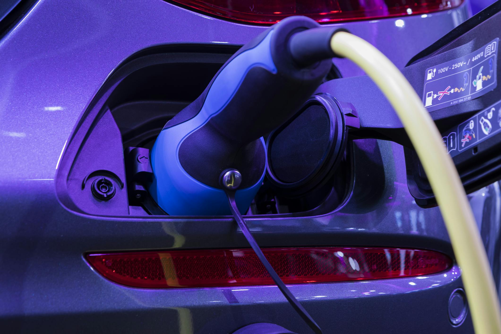

Higher Power and Faster Charging
Charging time compared with filling the tank of an internal combustion vehicle is a major barrier to EV adoption. High-power DC fast charging systems, categorized as Level 3 chargers, can deliver up to 350 kW and have the capability to add charge to a battery equivalent to as much as 200 miles in only 10 to 15 min.
Future charging systems will have megawatt power levels, primarily for heavy duty vehicles such as large trucks and high-performance cars. The expectation is that these chargers will deliver a high charging rate to large batteries and add 15–30 miles of range/minute. Advanced battery thermal management systems, larger battery packs and new battery chemistries could dictate even higher mile/minute charging rates.
