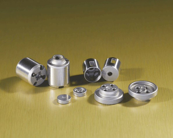

Grand prize in the automotive — engine category
These gasoline direct-injection (GDI) pumps could be the most-complex production assembly ever made by metal-injection molding.
in India won its prize for a MIM assembly that controls fuel flow in gasoline direct-injection (GDI) pumps made for Stanadyne Corp., Windsor, Conn. The four parts include a blank discharge check, a stop-discharge check valve, a valve-discharge check, and a CRV spring seat. Three of the parts are made of 440C stainless steel, and the fourth is made of 17-4 PH.
Indo-US MIM says this could be the most-complex, high-volume assembly ever made by MIM. It’s 35% less expensive than traditional versions, plus performs better. MIM lets engineers modify hole geometry to enhance flow dynamics for a 10 to 20% boost in fuel economy. The most complicated part, the blank discharge check, has intercrossing holes made by a machine using tooling with six side cores — three of which move independently.
