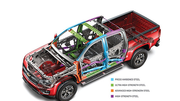

To avoid the cost of higher-priced metals and retooling, the automotive industry is continually looking for stronger steels that will work with current production lines. Many alloys can increase strength, but this would alter the metals’ formability properties, causing them to crack when being stamped into the desired part shapes. These challenges have already led to several grades of new steels. “About half the steel in cars being used today didn’t exist 15 to 20 years ago,” said Dave Paratore, President and CEO for NanoSteel.
Stronger Steels
The first generation of advanced high-strength steels (AHSS) expanded performance properties so that thinner-gage sheeting could be used for vehicles, but it also reduced formability and thereby limited part designs. The second generation was an attempt at making strong steels more ductile, but these steels weren’t able to be used commercially. This could be why the auto industry pushed for a third generation, which aims to combine strength and ductility while maintaining lower costs and commercial viability.
Strength and elongation—not density—is changed in AHSS. With the increase in strength, less material is required for the same parts. AHSS is more expensive than normal steels, but using less helps offset the cost. The reduction in materials also cuts down on the amount of energy that goes into making a car, which helps companies maintain a “green” image. In areas such as British Columbia, Australia, and others that have carbon taxes, lightweighting can increase company profit by reducing these emission taxes.

Metallurgists are experimenting to find or develop metals that are both malleable and strong to create lightweight parts. Some of the first to emerge combined small quantities of many alloys into a fine dispersion of carbides that can form into an almost pure ferrite matrix. Called high-strength low-alloy steel (HSLA), this metal maintains formability by reducing the steel’s normal volume fraction of pearlite (a hard and brittle mixture of ferrite and cementite formed when cast iron or steel cools), and increases strength thanks to finer grain size. But making the new metal requires 20 to 30% more power than carbon-steel production.
Harder metals that require more processing power becomes a problem when it comes to the scale of the automotive industry. “The cycle time for a large auto company is around 750,000 trucks a year—that’s about one truck per minute,” said Engineering Quality Solutions’ Schaeffler “An F-150 body could have hundreds of parts. If ductility of a material increases cycle time, meeting production quotas on schedule might be impossible.”
“For decades, steel has been made in 150- to 200-ton batches while controlling the constituents by the parts-per-million,” explained NanoSteel’s Paratore. This allowed development of many types of steels. One version, called dual-phase (DP) steel, is a hard but brittle martensite that’s surrounded by softer, more ductile ferrite. This steel has the strength and malleability that works well for crumple zones and parts requiring more complex geometry. Unlike aluminum and HSLA, DP can increase its strength by up to 70% by work hardening and bake processing.
With so many grades of AHSS, a simplified root-cause analysis of what’s trying to be accomplished would be the attempt to increase the processing window between the yield and tensile strength of new materials. On a stress strain graph, the distance and slope between the yield and tensile strength are important. The slope of the log strain versus log stress is called the n-value. A steeper slope, or higher n-value, indicates a material’s ability to displace stress across the material and elongate more before necking. This leads to better sheet-metal formability, which is a critical factor for stamping.
The higher n-value means that it can absorb more energy without necking or failing. For the automotive industry, a material’s sheet-metal formability with a higher n-value can lead to improved crash and impact performance.
Determining the metal that works best always depends on the application. Transformation induced plasticity (TRIP) maintains its work-hardening rates despite increases in strain. This makes TRIP steels work well for frame rails. Another property to consider is the fatigue strength. Steels can be designed to offer an endurance limit, which isn’t the case with aluminum. This makes steel a better choice for parts that will experience high cycle and dynamic loads. Fatigue failures can also be caused by corrosion. If oxidation resistance is a concern, aluminum might work better than steel. Other concerns surround the metal’s ability to be used in different processes.
