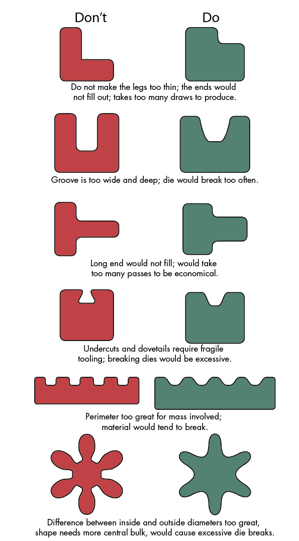

Ideally, parts should have a central bulk rather than some extensions or excessive peripheral areas. Here are some examples of the shapes to avoid.

Like all metal-working processes, cold drawing has some limitations. For example, it cannot be used to make tapers, undercuts, or deep grooves. Ideally, parts should have a central bulk rather than some extensions or excessive peripheral areas. Here are some examples of the shapes to avoid:
