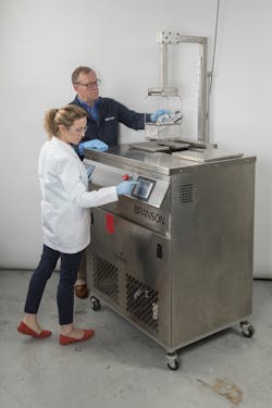

Vapor Degreasing Debinding
One of the most efficient and cost-effective ways to remove binders from parts is to use specialty engineered debinding fluids inside a vapor degreaser. A vapor degreaser boils a specially engineered, non-flammable debinding fluid into a dense vapor that rises through and is trapped inside the machine. The boiling fluid and vapors combine to debind, clean, and dry the green parts inside. When the vapors reach condensing coils at the top of the machine, the coils chill the vapors back into a liquid state. This liquid falls into a trough and is made ready for another use. This recycling happens for hundreds of hours before the debinding fluid needs to be refreshed or replaced, making debinding both efficient and environmentally friendly.
Depending on the part’s material and the binders used, the binders are removed from green parts by either immersing them in the boiling debinding fluid, by holding them inside the vapor blanket inside the vapor degreaser, or a combination of both. All methods rely on the debinding fluid penetrating the parts to effectively dissolve the wax and to create enough porosity within the green parts to allow the binder to evaporate quickly before sintering.
The debinder fluid dissolves the wax binders and washes them out of the green parts. It also creates a network of interconnected cavities, allowing the debinding fluid to easily flow throughout the entire part, ensuring thorough debinding. Vapor degreasing is easily programmable and allows for excellent process control and repeatability. Green parts are consistently and effectively debound without variation through each and every cycle. Most importantly, vapor degreasing allows the green parts to come out clean, dry, and cool enough to immediately transfer them to the sintering oven. There is no extra cool-down time needed. Wax debinding in a vapor degreaser enables quick, efficient processing resulting in shorter molding cycles and faster production runs overall.
