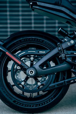

There is no traditional transmission or clutch. The motor’s output shaft mates to a gearbox with a 9.71:1 gear reduction running in an oil bath. A gearset then turns the rotational output 90 deg., aligning the drive belt sprocket with the rear wheel. A final-drive belt send power from the gearbox output pulley to the rear wheel.

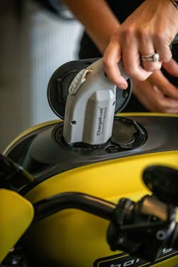

The RESS can be recharged using DC Fast Charge (DCFC) through a SAE J1772 connector or a CCS2 (an IEC type 2 charging connector common in Europe and some other countries). DCFC takes a battery from 0 to 80% capacity in 40 minutes or to 100% in 60 minutes.
All Harley-Davidson dealers selling the LiveWire will have a public DCFC charging station. Buyer get two years of free charging at participating dealers. Additionally, Harley will provide U.S. bike owners with 500 kWh of free charging at Electrify America DCFC charging stations.
The motorcycle comes with an on-board Level 1 charger that plugs into standard 120-V (or 240-Vt) household outlets with a special power cord that stores below the motorcycle seat (the bike’s only storage). It delivers 13 miles of driving time for each hour of charging or a full charge overnight.
The LiveWire motorcycle may be charged with a Level 2 charging station, but it will charge at the Level 1 rate. The charging port is located below a cap in the bodywork forward of the motorcycle seat.

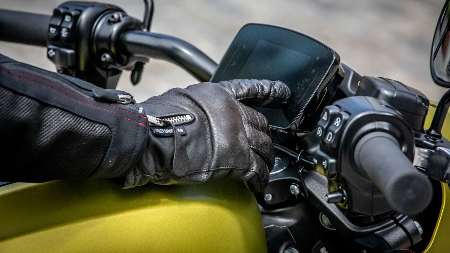

There are no dials. Instead a 4.3-in. color TFT touchscreen above the handlebar gives the rider a wide range of information on a bright and easy to read display. Harley made sure the water- and weather-resistant screen can detect the rider’s touch even if they are wearing gloves.
The display is tilt-adjustable to give riders the best viewing angle and the screen brightness adjusts automatically. The touchscreen only works when the motorcycle is not moving, but many display options can be changed by using joysticks while riding. Riders also control music and phone functions with the joysticks.
The screen always shows speedometer with speed, range and high-voltage battery status (percent remaining), as required by motor vehicle regulations. It can be customized by adding a power meter showing how much of the available power is being used as the motorcycle is being ridden, ride mode indicator, charge status and alert information keyed to turn signals (ABS, Traction Control and Check Engine/Battery Overheat, for example).
