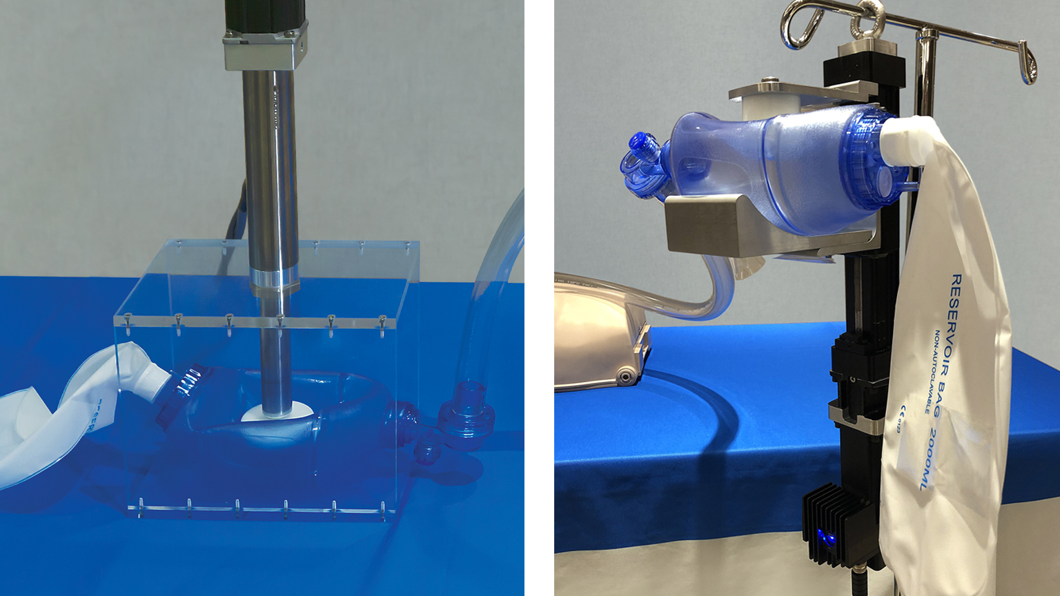

After looking at open-source designs for emergency ventilators, a team of engineers at Tolomatic got together and came up with some new ideas for building ventilators out of ambu bags. Within a week the team had created two designs that use the company’s screw-driven electric actuators. The designs automate the control of air volume and how often it is supplied to patients—a significant improvement over manually operated ambu bags.
“The team’s approach was to automate a traditionally manual process using electric linear actuators and ensure patients would continue to get air for days or weeks,” says Andy Zaske, Tolomatic’s vice president of sales and marketing. “The actuators control the velocity, frequency and stroke length of the move down; how long to pause; and then the velocity, frequency and stroke length of the return move.”
“The actuators give doctors and nurses complete control over the flow of oxygen going into the patient’s lungs, unlike more traditional camming or pneumatic cylinders we have seen on other open-source designs,” says Zaske. “Whether the patient is young, old, large or small, they can adjust how much air and how frequently it is delivered to the patient.”
Tolomatic’s prototypes use either an electric rod actuator (ERD15) or a rodless electric actuator (BCS). Both are screw-driven linear actuators that convert rotary power from a servo motor into linear motion. Rod-type actuators have a rod which extends and retracts from the main body of the actuator. Rodless actuators lack a rod. Instead, the travel or stroke is contained within the actuator. For this application, the rod actuator needs a housing to hold the ambu bag and the actuator mounts to the housing. The rodless actuator is more compact and can hold and compress the ambu bag within its rails.
Optimal stroke length for both prototypes is 2.5 in., with a minimum of 25 lb of force at the output shaft. Both are rated for at least 100 lb of force. The Direct-drive (or in-line) motor configuration simplifies the design and cuts costs. Add gearing to the design would let it accommodate a wider variety of motors.
These new designs seem to be an improvement over ambu bags modifications that automated the process using single-direction camming or a pneumatic actuator. These do not let healthcare workers adjust the stroke length, only the breath frequency. As a result, the same volume of volume of is delivered to all patients and the resulting motion profile is not like a typical breathing cycle.
Linear actuators, on the other hand, can quickly accelerate and maintain speed over a specified distance, providing more continuous volumes of air per compression and a more typical breathing cycle. The total control of motion from a linear actuator also lets air volumes be adjusted for a patient’s age, size or current needs.
