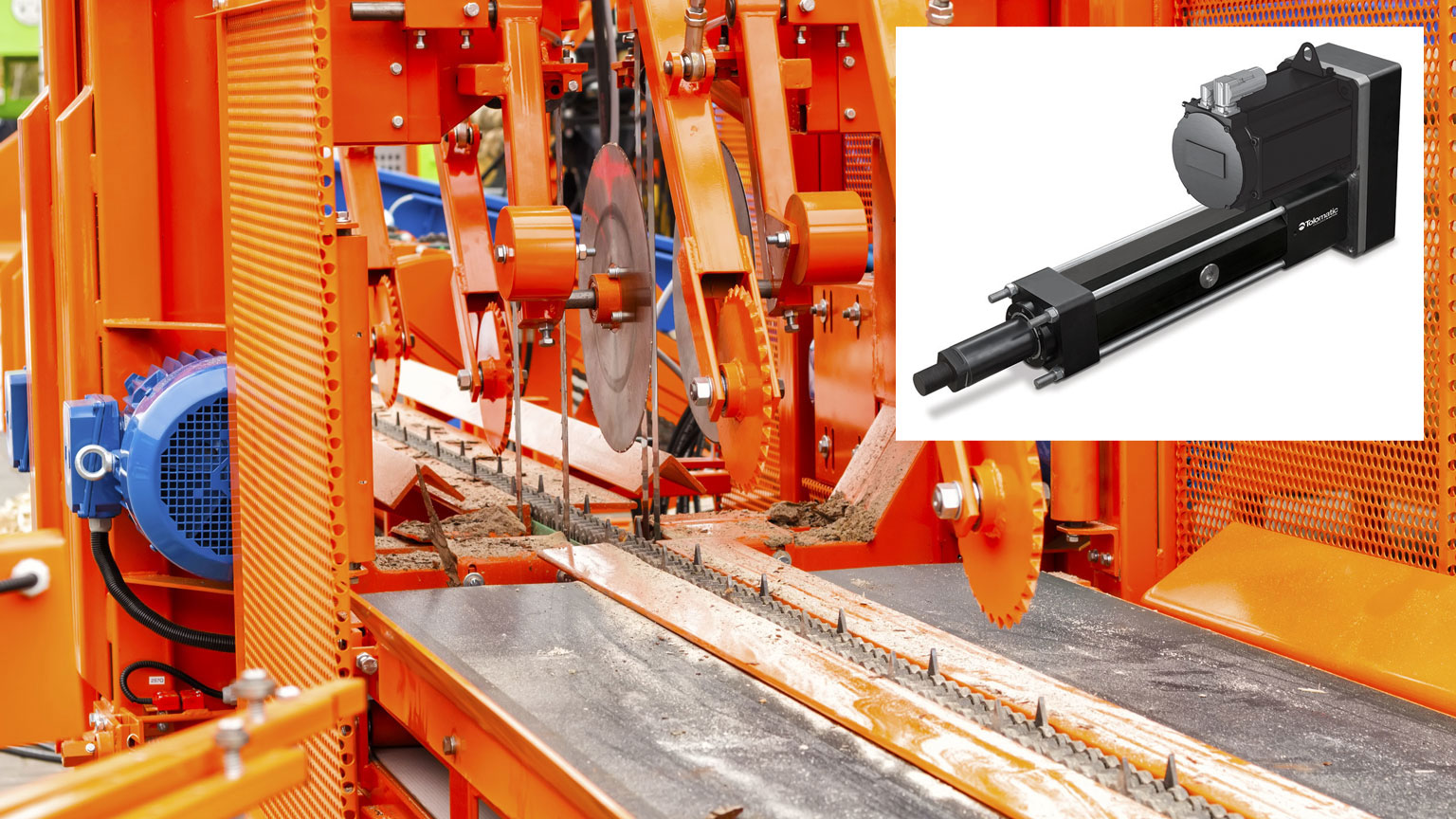

For example, a lumber-processing equipment company needed to replace a hydraulic cylinder in a log-cutting application to eliminate the potential of hydraulic fluid leaks into the environment. The company chose to go with a Tolomatic electric ball-screw rod actuator with a 42-inch stroke to move the saw blade. It has an IP67 rating, indicating the actuator was built to be protected from splashing water and debris. The actuator was also lubricated with a high/low-temperature grease for consistent performance in all weather conditions.
