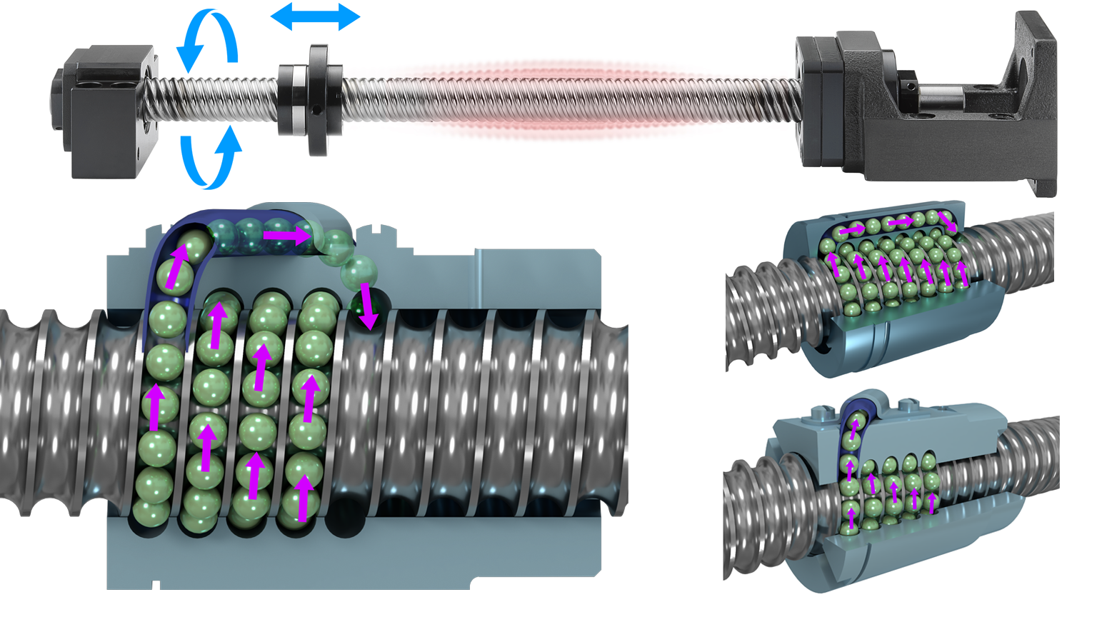

A ball screw assembly consists of a screw and a nut with recirculating ball bearings. The connection between the screw and the nut is made by ball bearings, which roll in the matching ball forms within the nut and screw shaft. This distributes forces over many bearings, giving a relatively low load per ball and a low coefficient of friction, contributing to higher speed operation capability (Fig. 1).

There are three major types of returns systems: internal, button and external (Fig. 3). The purpose of the returns is to provide re-circulation of the ball bearings in the nut. The return system design affects the nut’s speed limitations.
The external return systems typically utilize a small finger that extends into the ball groove to deflect the ball into the return path. At high speeds, this finger can flex from the ball bearings hitting it and eventually break off. The button and internal designs are generally more robust and typically can operate at higher speeds than the external return system.
