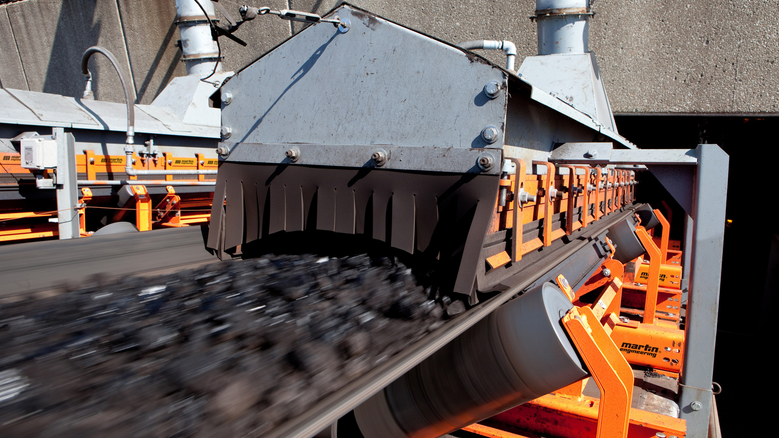

Using the Hierarchy of Controls along with the Design Hierarchy, engineers can construct an “Evolved Basic Conveyor” that meets the needs of modern production and safety demands. An Evolved Basic Conveyor is a standard bulk material handling conveyor designed to allow easy retrofitting of new components that improve operation and safety, solving or preventing common maintenance problems.
Installing or providing for maintenance-minded components in the loading zone can greatly improve safety and reduce downtime. These components include slide-in/slide-out idlers, impact cradles and support cradles. On larger conveyors, maintenance aids such as overhead monorails or jib cranes assist in moving and replacing components.
Engineers should also ensure the conveyor has adequate access to utilities, typically electricity and/or compressed air, to facilitate maintenance and performance. Next-generation conveyor designs may even have specially engineered idlers capped with an independent power generator that would that use the conveyor’s movement to generate power for a wide array of autonomous equipment.
On conveyors, dust, spills and belt tracking are top concerns for many safety professionals. Field tests have shown that enlarged skirtboards and engineered settling zones promote dust settling and reduce fugitive material (i.e., material that escapes the conveyor and ends up in the surrounding area). Curved loading and discharge chutes control cargo transfer for centered placement and less turbulence. As the load is centered on the belt, guides ensure even travel through the take up for consistent belt tracking.
Any transfer point is prone to buildup and clogging if conditions such as humidity, material wetness, volume or surface grade is right. Flow aids such as vibrators or air cannons on chutes can keep material moving, extend conveyor life and reduce the safety hazards associated with manually clearing clogs.
