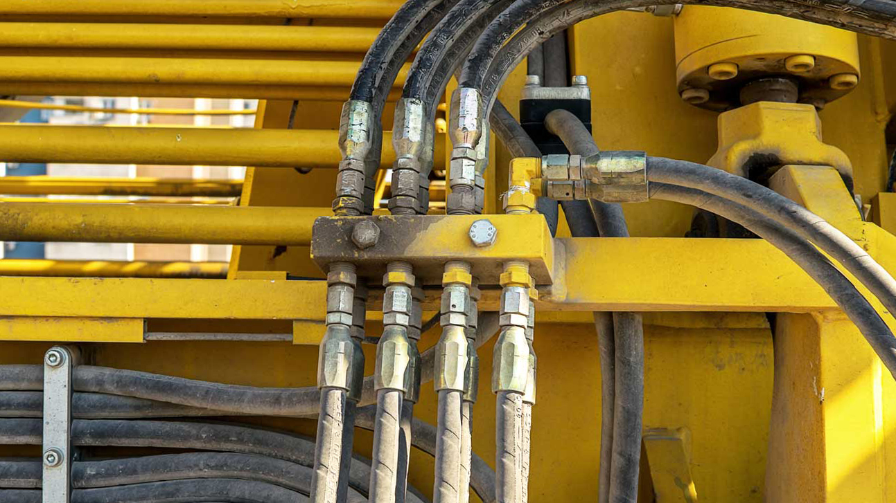

Suppliers of hydraulic hose assemblies will face this common scenario: An end-user brings in a worn-out hydraulic hose to be replaced, but the couplings needed for this particular size hose are out of stock, backordered or the store doesn’t stock the couplings needed to replicate the original hose assembly. However, you do stock the correct couplings in a smaller hose size inside diameter (ID).
The logical solution might be to rebuild the hose assembly using the smaller size hydraulic hose with a jump-size fitting. Though this may seem like a harmless solution, replacing a hose assembly with a smaller hose size than what was designed for that hydraulic system could cause unintended harm and create inefficiency to the equipment.

Flow velocity is an important consideration when replacing a larger hydraulic hose ID with a smaller hydraulic hose ID. When an existing hydraulic hose is replaced with a new hydraulic hose that has a smaller ID, the same amount of fluid that was flowing through the original, larger hydraulic hose is now forced through the new, smaller hose. This will restrict flow and increase downstream pressure, thus causing flow velocity to increase.
In some situations, this might not be a problem, so it is important to properly analyze the situation. An easy option to avoid this problem is to size-up to the next larger hose size. However, larger hoses usually come with a higher price, plus larger hoses take up space and could even decrease the customer’s equipment performance.
