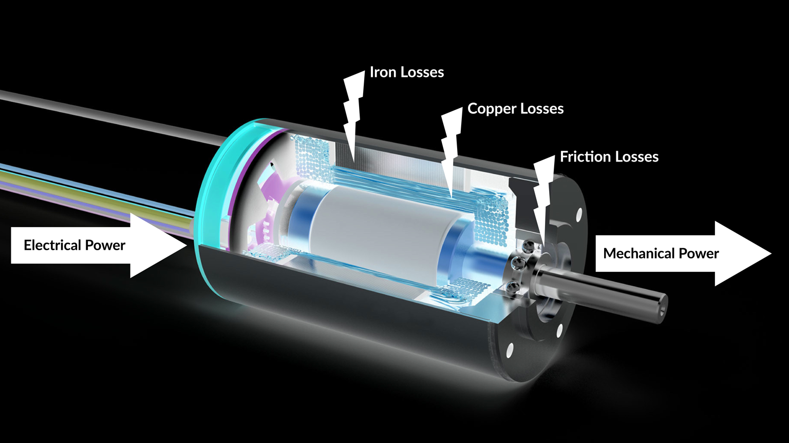

Cutaway of a Portescap BLDC

Brushless DC (BLDC) motors transform electrical power into mechanical power. However, there’s no such thing as a perfect motor; there are always losses in the transformation. The three main types of losses created during the conversion are friction losses, copper losses and iron losses.
Friction losses are caused by the ball and bush bearings, and they are function of the application’s use (speed, load and acceleration) and environment (temperature, dirt and other factors), plus the bearing’s intrinsic characteristics such as material, wear, lubricants and sealing.
Copper losses, also called joule losses, are created by the coil’s resistance. Torque is linearly proportional to the current, so the more torque a motor provides, the higher the copper losses. This follows the quadratic function shown here:
Copper Losses = R × I2
R is resistance and I is current.
Keep in mind that the resistance will increase as the motor heats up (according to the equation below). This will reduce the efficiency.
R = R0 × (1 + (𝑦 × ΔTemp))
R0 is the resistance value at ambient (usually listed in the datasheet), and 𝑦 is resistance factor of copper (0.004/°C).

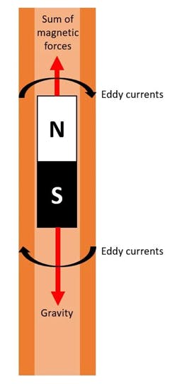

A small experiment can explain this phenomenon. When a magnet is thrown into a slightly ferromagnetic tube—like copper or aluminum—the speed of the falling magnet is much lower than what would be expected.
Why does this happen?
Lenz’s Law states that:
Induced EMF = −Δɸ/Δ𝑡
Δɸ is the rate of change in magnetic flux and Δ𝑡 is the corresponding change in time.
According to Lenz’s law, when the magnet falls through the tube, the changing magnetic field induces current that flows in a direction that opposes the change in the magnetic field that produced it, thereby reducing the magnet’s speed.
