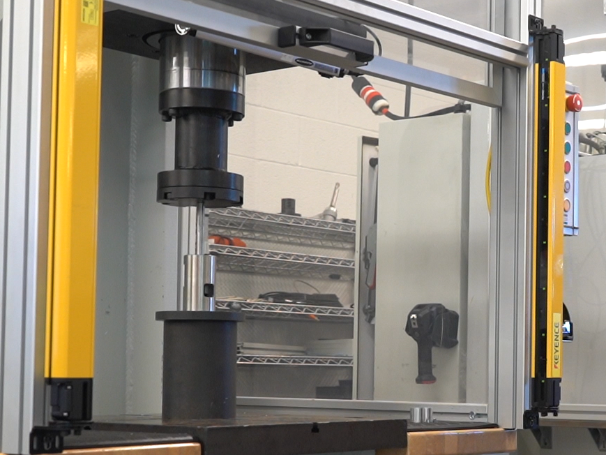

The manufacturer is a long-time customer of Promess, a provider of monitoring and motion systems for various assembly and test applications. When manufacturing transmission cases, it had typically used Promess’ Electro-Mechanical Assembly Press (EMAP) to press a steel ball bearing and seal the cross-drilled hole to prevent any fluid losses.
However, the manufacturer found this method did not work well for its thin-walled transmission case. It caused the housing to crack as well as unacceptable leakage rates and warranty issues.
The EMAP is designed to monitor and precisely control peak force and final position. But an evaluation of its use for the thin-walled case established only distance was controlled because the ball pressing application was programmed by a user to stop at a specific distance. Therefore, the tight tolerances normally used for the dimensions of the ball bearing and the diameter and surface finish of the cross-drilled hole were not followed, leading to cracks and leakage issues.

Upon examination of process used by the transmission manufacturer, The Lee Company and Promess determined adjustments were necessary to both installation of the Betaplug and programming of the EMAP.
Engineers from The Lee Company determined that when installing the Betaplug, it was being over-pressed. This led to the creation of excessive radial force when the pin moved to expand the plug’s body and extruded the plug in the installation bore.
The manufacturer also wanted to install the plug at a fixed point in the bore because it knew this is where the steel ball bearing best performed. However, this was not a suitable option for the Betaplug because it caused excessive installation force to be created.
Despite these findings, the manufacturer wanted to continue with its processes because the plugs were not failing in the field and the company decided it could accept the scrap rate.
Promess engineers evaluating the process recommended changing the programming for the press. Instead of measuring force level or distance, they suggested combining EMAP instrumentation with data processing provided by Promess’ Motion Controller. Doing so would enable the measurement and control of absolute force and distance as well as more complex aspects such as the rate-of-change between those measurements.
With these more detailed measurements, the press can be stopped once the pin is correctly inserted into the plug to prevent excessive force and over-insertion from occurring. In addition, the technology is capable of detecting if parts are upside down, sideways or missing a pin/component.
To ensure this new programming would work for the transmission manufacturer, engineers at Promess and The Lee Company conducted extensive lab testing. This testing was done prior to making any changes at the manufacturer’s facility.
The combination of updating the EMAP programming and correcting the Betaplug’s installation resolved the yield issues and reduced the manufacturer’s scrap rate. Since these changes were made the manufacturer has also not received any warranty returns for leakage issues.
