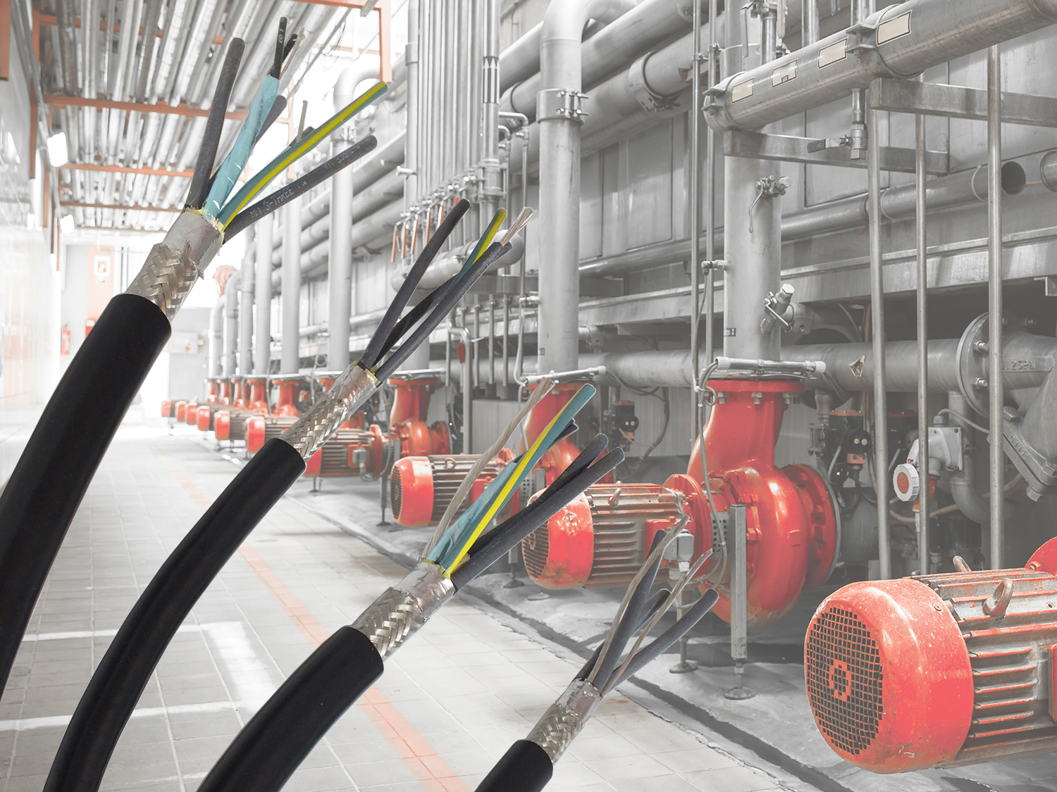

VFD Cable Construction Elements
Cable vendors such as SAB North America offer cables specially constructed for VFD applications. VFD cables typically have a copper or tinned copper conductor due to the metal’s high conductivity and low resistance. These conductors are typically flexible, so the cable can withstand bending motions common in industrial applications without incurring signal losses. Cable selection criteria should also include the jacketing materials used to protect the cables against harsh conditions.
Cable sizes for VFD applications can range from 500 KCMil to 18 AWG. But when it comes to the essential elements of a cable, the insulation material sets VFD cables apart from traditional cables. Following is an overview of various conditions that can harm VFD cables, along with the insulation features to look for in a VFD cable to ensure a long, reliable lifetime:
  • Reflected waves. A mismatch of impedances between a VFD’s motor and its cable can cause frequency waves to bounce back to the drive. When this occurs, the insulator can break down and overheat the cable.
  • Corona inception voltage/corona discharge. Voltages in VFD systems can vary greatly, oscillating from zero to peak voltage. When there’s a spike of high voltage, air around a local electric field becomes ionized. This corona discharge can melt insulation and damage cables.
To address these issues, one option is to use a PVC-insulated cable with greater thickness than prescribed by National Electric Code (NEC) standards for THHN wire in conjunction with a high-heat nylon thermoplastic. However, the NEC has changed its guidelines stating that PVC-based conductors are no longer permitted for use in VFD applications.
Cross-linked polyethylene (XLPE) is now the recommended insulation material for VFD cables, per NEC. With lower capacitance ratings than PVC, XLPE minimizes charging currents, provides better heat resistance and offers protection against corona discharge. Lower capacitance is a particularly important characteristic for longer-length cables since long runs can also create reflective waves. For these reasons, VFD manufacturers often suggest cable with core insulation thickness of 32 mm or greater of XLPE insulation.
Consider for example SAB North America’s range of reliable UL- and CSA-listed VFD cables designed to minimize downtime and provide long life for drives and system equipment used in automation applications. The cables come with XLPE insulation rated for RHW-2 and XHHW-2, making them compliant to the NFPA 79 code, 2018 Edition. SAB VFD cables carry NEC TC-ER ratings, indicating that the cables can be installed with or without a cable tray.

In addition to providing VFD cables with robust insulation and oil- and flame-resistant PVC jacketing, the SAB VFD cable lineup features a foil and tin copper braid shield for 100% protection against EMI from spikes, harmonics and power distortions. VFD cables also carry NEC Class 1, Div. 2 classification for use in hazardous locations. Highlights of the VFD cable offering include:
  • VFD XLPE TR/VFD XLPE TR D, which comes with or without an integrated drain wire.
  • VFD Symmetrical XLPE TR, with three phase leads and three symmetrical tinned copper grounds to minimize the risk of motor failure from common ground current.
  • VFD Combo XLPE, with one or two pairs for temperature sensing or braking. Multiple pair AWGs are available.
  • VFD XLPE 2 KV TR, a sun- and flame-resistant VFD cable rated up to 2,000V.
  • Cable glands and termination kit. The cable glands come with built-in grounding mechanisms that contact the cable shield to provide effective EMC protection plus protection against impacts and vibrations. A termination kit is also available for grounding a shield to a metal enclosure.
