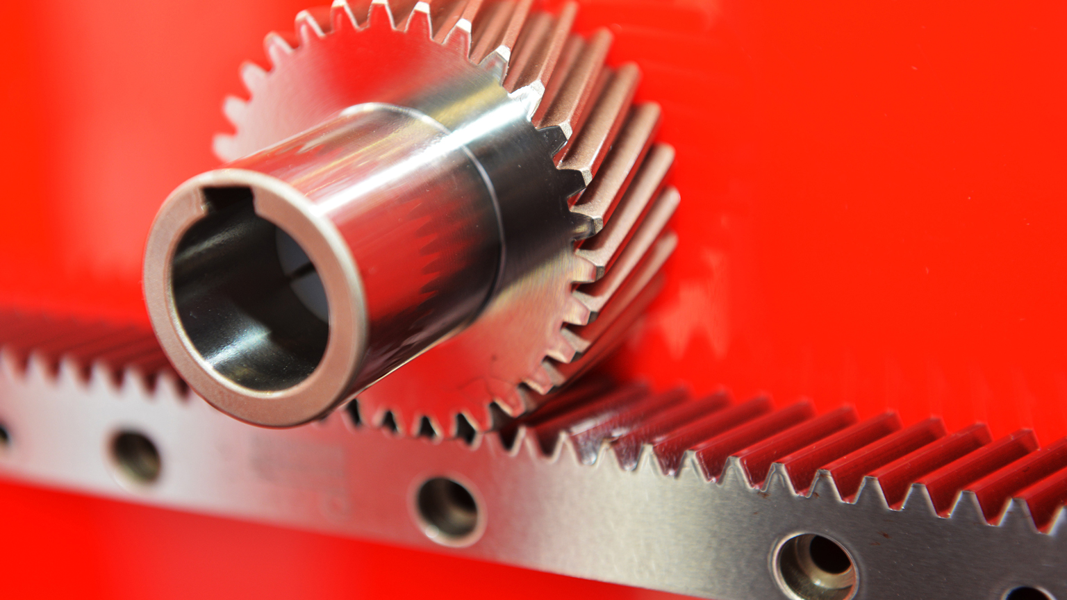

New-generation rack-and-pinion drives offer high dynamic performance and unlimited travel distances. Some use high-grade servo gears and actuators with backlashes of less than 1 arc-min. and efficiencies of up to 98.5%. Some preassembled gear-pinion units can even run true to 10 µm for smooth, accurate motion.
Many of these advanced features and benefits stem from technological advances made in a broad spectrum of industries. For example, state-of-the-art machining and grinding have greatly improved the precision of rack-and-pinion drives.
Another example of a tech upgrade for rack-and-pinion drives are the high-end racks, the row of teeth the pinion gear rides over. Some are laser etched so that the cumulative pitch error is just ±12 µm over a 500-mm length. This lets operators manually adjust target accuracy. This is useful for precisely synching the motion of a pair of racks. (Two rack-and-pinions in parallel are used to move a single assembly such as a gantry.)
Accurately machined racks also let some machines run without external feedback devices; in contrast, other linear systems need expensive and often complex feedback devices for positioning and coordination.
If noise needs to be kept to a minimum, using a helical rack with an intelligently chosen helix angle might be the answer. They are noted for running quietly at high speeds and having a higher load carrying capacity, all thanks to the helical rack’s larger tooth contact ratio. And single-pitch errors between helical teeth can be as low as 3 µm.
Helical gearing engages smoothly and quietly. This improves the surface finish of parts made on machines that use a helical rack-and-pinion to move the cutting tools.
Modern machining also lets gearmakers adjust the pinion gear’s profile. This is helpful when all the teeth of the gear are not made correctly, a problem prevalent on gears with relatively few teeth. In such cases, the machining method removes too much metal and the root of the tooth is thinner than it should be, or undercut.
To solve this problem, gearmakers carry out profile shifting, adding or subtracting metal to get the proper shape, which bumps up its load capacity.
Rack-and-pinion drives give engineers plenty of design flexibility for getting the performance and control that matches their application’s needs. The design team can use different pinion sizes, gear ratios and damping levels.
Rack-and-pinion drives do have their downsides. For example, putting the pinion and rack teeth too far apart causes backlash, which lowers precision. And misaligned mounting can damage the gearbox bearings, which leads to higher motor currents, noise, and even failures. To avoid these pitfalls in many applications, the pinion should be properly distanced from the rack and the rack should the mounted on a flat surface and perpendicular to the gearbox to within about 25 µm.
Rack-and-pinion drives can be preloaded to eliminate backlash and increase stiffness. To do this, two pinions run on the same rack. The master pinion drives the mechanism while the slave pinion generates torque to counter opposing forces on the teeth it engages. This lets inertia and resistance prevent backlash, even during load changes. It also increases the drive’s rigidity and boosts control dynamics. The slave pinion does oppose the linear motion, so efficiency falls a slight bit.
