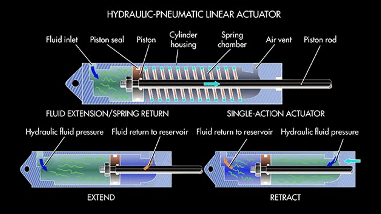

Hydraulic-pneumatic linear actuator

Pneumatic actuators have a piston inside a hollow cylinder that is moved through that cylinder by pressurized air entering from a compressor or pump. This linear motion can move a load or create a force. The piston returns to its original position using a spring or pressurized air supplied to the other side of the piston.

Hydraulic linear actuators operate similarly to pneumatic actuators, but a pressurized incompressible liquid (hydraulic fluid) supplied by a pump rather than pressurized air moves the cylinder.
