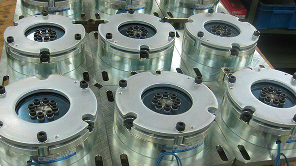

The first step in choosing an appropriate brake is to determine the torque required in the application. Usually somewhere under 20,000 lb-ft, electric spring-set brakes become an option. They are often the preferred choice for lower-torque applications because cost is a main driver. For higher-torque applications, hydraulic and pneumatic brakes are often better suited.
Hydraulic and pneumatic holding brakes can easily achieve 20,000 to 500,000 lb-ft in torque. These large brakes can be either multiple-disc-style or caliper-disc-style brakes. Pneumatic or hydraulic brakes tend to be better for stopping high-inertia loads. Many times they have replaceable friction discs and can be serviced. Because their power is easier to control, they can give a softer stop in high-load applications such as amusement park rides.
Electromagnetic brake rated to 20,000 lb-ft torque for an elevator.

Electromagnetic stopping and holding brake, Ogura MNB series with adjustable torque.
