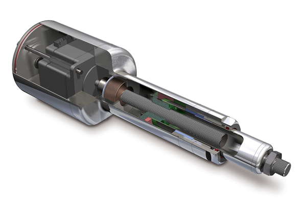

Off-the-shelf stainless-steel actuators are an economical option. Such rod-style actuators also have protective motor enclosures to resist chemicals, water, and dust.
