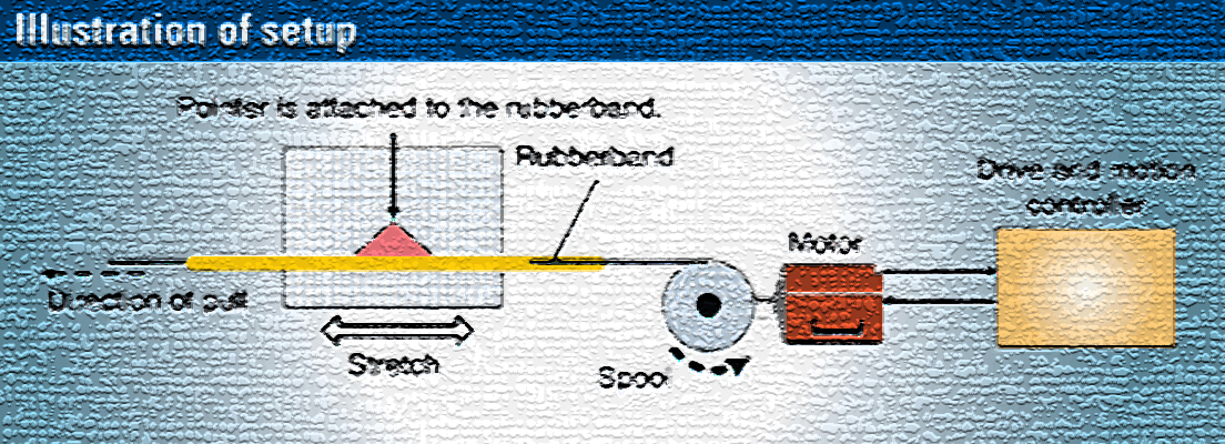

To the laboratory
Check out the youtube.com video — Torque Control Deep-Dive Video 1 — which features a rotary brushless dc motor exhibiting modest but measurable detents.
Can an electronic compensation technique described above improve the performance of this low-cost motor? Yes.
Note that it is actually much easier to feel torque output than it is to see it; in fact, it is rather uncanny to twist the output shaft of a motor like the one featured in the video — and feel its detents disappear when a compensator is switched on.
In the video, the motor shaft is connected to a pulley, and wire is wound around the pulley to run it into to a sensitive hand-made scale consisting of a rubber band with an indicator glued to it. As the motor spools out, the thin elastic stretches by an amount proportional to the force required to move the motor — determined by the motor's torque output at that position.
