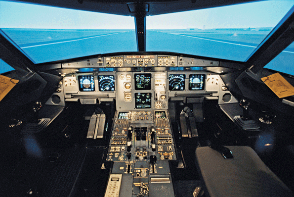

Flight simulators, such as this one for a military helicopter, should closely resemble the actual cockpit and controls. The realistic controls, together with visual cues from outside the cockpit (through the windscreen) give pilots the sensation of flying.
