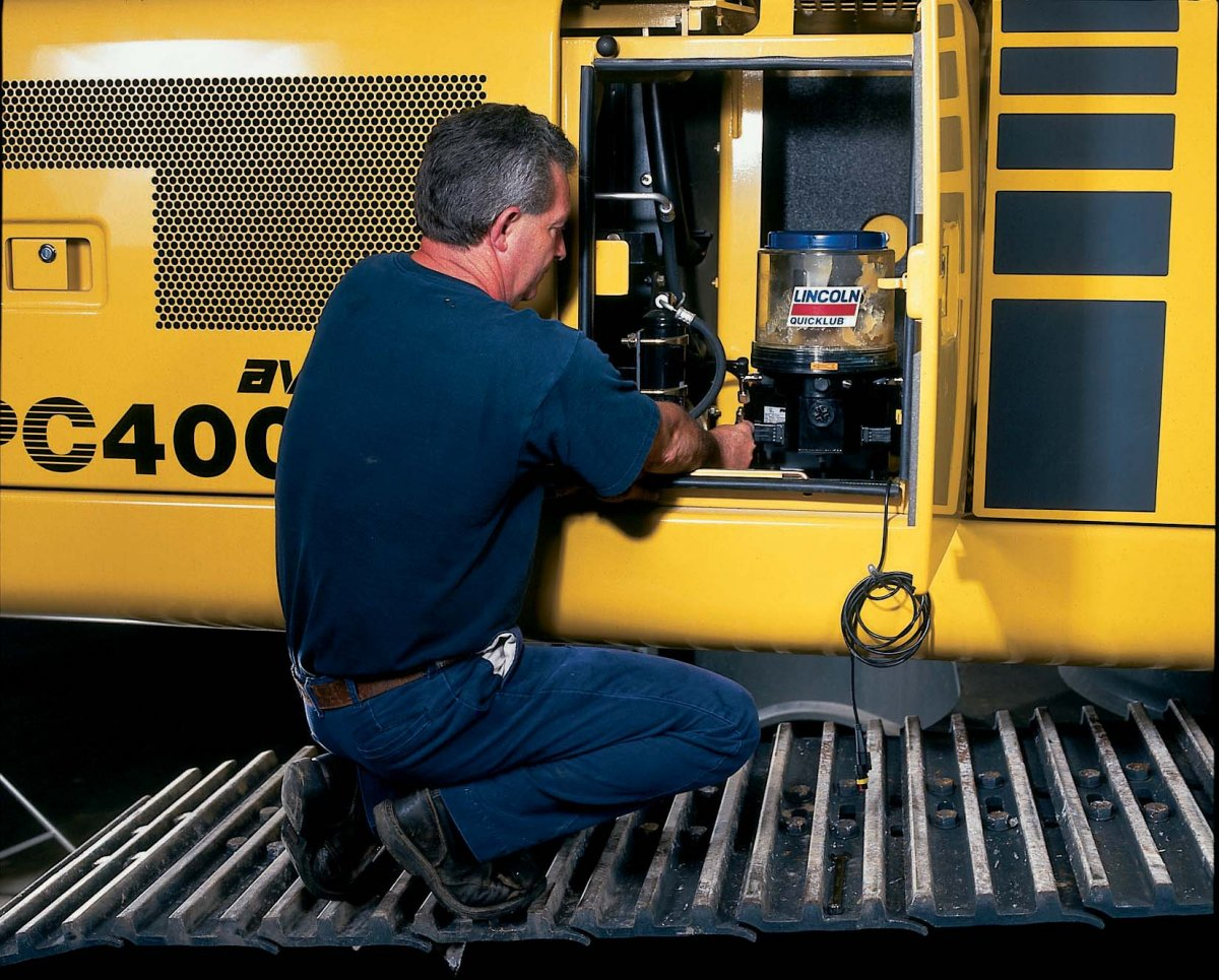

Lincoln's full lubrication solutions help farmers increase their overall profits by keeping their machinery up and running. Often, farmers will maintain their own lubrication systems using components and services from various suppliers. But without proper consultation, they may choose lubricants based on their initial price points, and not consider potential damage it could have on moving parts. For example, lubricants that are not inert with certain metals at high temperatures and mixing conditions can result in build-up, and others may thicken in contact with sugary residue on mill bearings. It is also important to consider that lubrication reaches all the necessary grease points to reduce wear.
Lincoln Lubrication SA showed its automated lubrication and Muster II fire suppression system on a crop sprayer at Nampo 2017. The metering device ensures that all grease points are lubricated by sending oil from a single location.
The company installs its progressive lubrication systems to allocate flow to individual mill bearings. It sends high volumes of oil to metering devices that divide flow to send oil to individual grease points. Serving 14 sugar mills in South Africa and 3 in Swaziland, the company also installs digital monitoring systems that send real time data to the company’s maintenance team.
