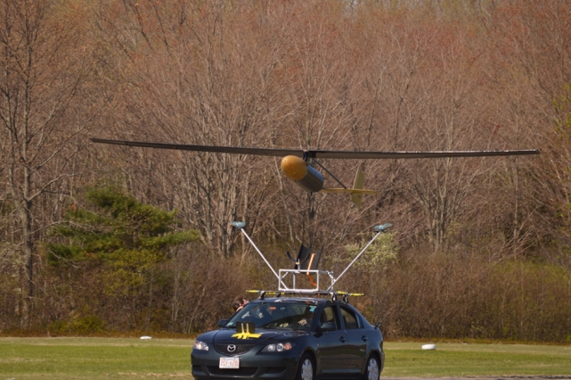

Last fall, the team built a prototype following the dimensions determined by the software tool. To keep the vehicle light, they used carbon fiber for its wings and fuselage, and Kevlar for the tail and nose cone, which houses the payload. They designed the UAV to be easily taken apart and stored in a FedEx box, so it can be shipped to any disaster region and quickly reassembled.
This spring, the students refined the prototype and developed a launch system, fashioning a simple metal frame to fit on a typical car roof rack. The UAV sits atop the frame as a driver accelerates the launch vehicle
