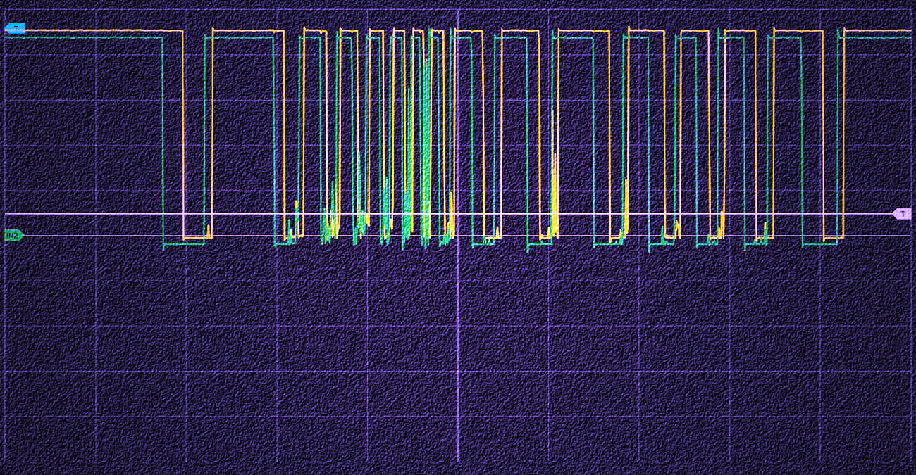

When supplied with 5 VDC, the encoder’s outputs stayed high at about 5VDC (Fig. 2). Rotating the encoder shaft plunged the outputs low. The length of time that the lines stayed low was proportional to the speed at which the shaft was rotated. The noise generated from state changes on the encoder is illustrated in Figs. 3 and 4. As you can see, these aren’t the clean, bounce-free level transitions that are the sweet dreams of microcontrollers.
The encoder used has some debouncing circuitry onboard. I wanted to try and get this thing working without adding additional components, or else breaking down and wiring up a Schmidt trigger on each encoder output.

I tried to use a lot of other people’s code, and the results were…not good. The code may have been fine under other circumstances, but it wasn’t happening with my noisy friend. At times, specifically with falling edge interrupt triggering, it looked like the code was getting interrupted when it shouldn’t have been possible. Theoretically, the ATMega328 disconnects all interrupts the instant a hardware interrupt is triggered. However, it appeared that the rapid-fire triggering of the hardware interrupts happened so fast that the processor didn’t always get the chance to disconnect them.

A few final notes on the code: The interrupts were set to trigger on the RISING edge. That means that the normally high encoder pulses had to drop low and then back to high before anything would happen. This was done to sidestep as much of that noise as possible. Any variables used by the interrupt-service-routines are declared as a volatile byte. Data type byte was used for speed and data integrity.
The UNO uses an 8-bit processor and can only work on a byte at a time. If the 16-bit data type int was used, the processor would actually have to chop up the int variables into byte sizes, and an interrupt can occur while this is happening.  The qualifier volatile was used to have the variables loaded from RAM rather than a storage register. This was also done for data integrity because, in some instances, storage registers can be changed in unwanted ways by the call to an interrupt service routine.
