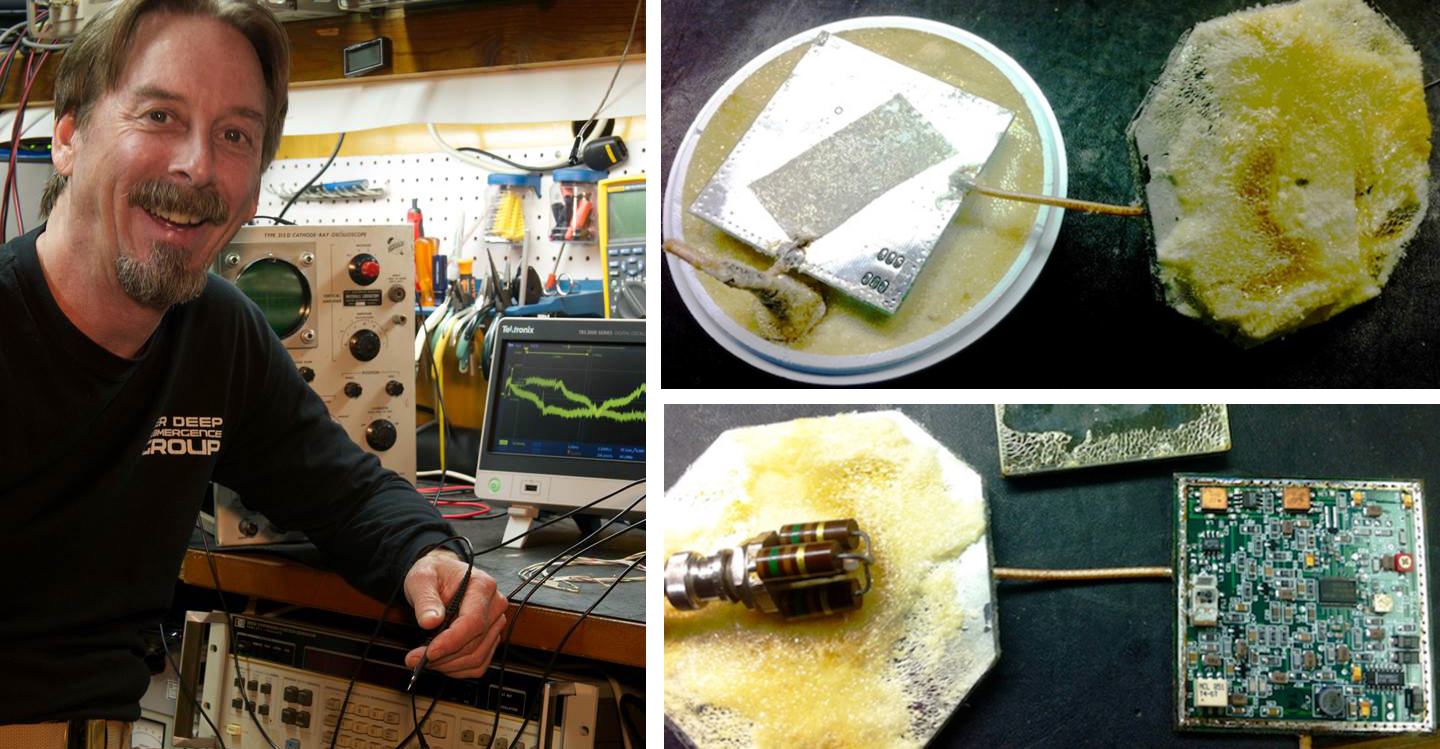

Spring arrived with warmth and flowers, the basement lab lost its appeal for a time, and the GPS oscillator was taken for granted as a reliable piece of gear. It was not to be. One afternoon, the status displayed “looking for satellites” when all had been well for months. Early the next morning, all was well again, and then in the afternoon it lost the satellites. This went on for several days and I finally hit on the thought that the attic was heating up in the afternoon sun and raising the temperature of the antenna. I brought the antenna down to the kitchen, put it in the refrigerator for a while, and then back outside. Yup, it was thermal. As long as the antenna was below 70ºF it worked ok, above that and no-go.
A phone call to the helpful tech at the manufacturer of the obsolete unit revealed a telling comment, “Oh yeah, we had a lot of trouble with that particular antenna as I remember.” Oh great! My bargain GPS rubidium frequency reference is turning out to be not such a bargain. I had continued to watch eBay for additional antennas as a spare, and none turned up. As most techs will understand, when a system they have assembled stops working, a certain determination to put it right starts to take over. It was with this determination that I undertook an investigation of the antenna.
Some testing with a signal generator and spectrum analyzer revealed that the down-converter in the antenna developed spurious sidebands when the temperature went up, so most likely there was a phase-locked loop (PLL) inside somewhere that was misbehaving. I just needed to get to it. Being sealed in a plastic dome, filled with expanding foam insulation, and soldered into an RF-tight enclosure, just getting to a point where I could put a probe on a circuit node was an epic journey in itself.
Surgery on the lathe with a Dremel cutter:
Burrowing down through the insulating foam:
The guts exposed:
Once opened up on the bench, and peering through the magnifier at a few square inches of surface-mount components, I was getting my bearings. Reading device numbers off a few of the ICs and Googling for datasheets began to reveal what was what. Here’s the input RF amp, a regulator, another RF amp, and look at this one.
Just put the probe there…
It’s a GPS down-conversion function block with internal local oscillator (LO), PLL, and mixer. Ok, we’re getting somewhere. Looking at the application example in the datasheet, and comparing it with the circuitry on the PCB, we see little resemblance. Hmmm… we’re poking around with the probe on my faithful old 465B, looking at PLL error voltage, and watching the spectrum analyzer.
All of a sudden, the erroneous sidebands disappear. I lift the probe and they return; probe down and the signal clears up again! Sound familiar? A feedback circuit, operating on the hairy edge of stability, falls over the edge only to be rescued by a few picofarads (pF) of added capacitance at the right place. Looking up the spec on my 'scope probe reveals that 13 pF seems to make my PLL stable. Digging into the SMD capacitor assortment, I find a 12-pF unit and rather clumsily manage to get it soldered on the right spot.
Two winters and summers later, and we’re still good. I’m left to wonder what the circuit engineers were thinking when that particular design was developed. Never attribute to malice what stupidity can explain came to mind, but there is a lot I still don’t know about electronics. Perhaps it was cost, perhaps it yielded better temperature stability within some narrow conditions, or something I have yet to learn about. Anyway, my story is not unique. Many a strange problem has been fixed by nothing more than putting a ’scope probe on the right node.
