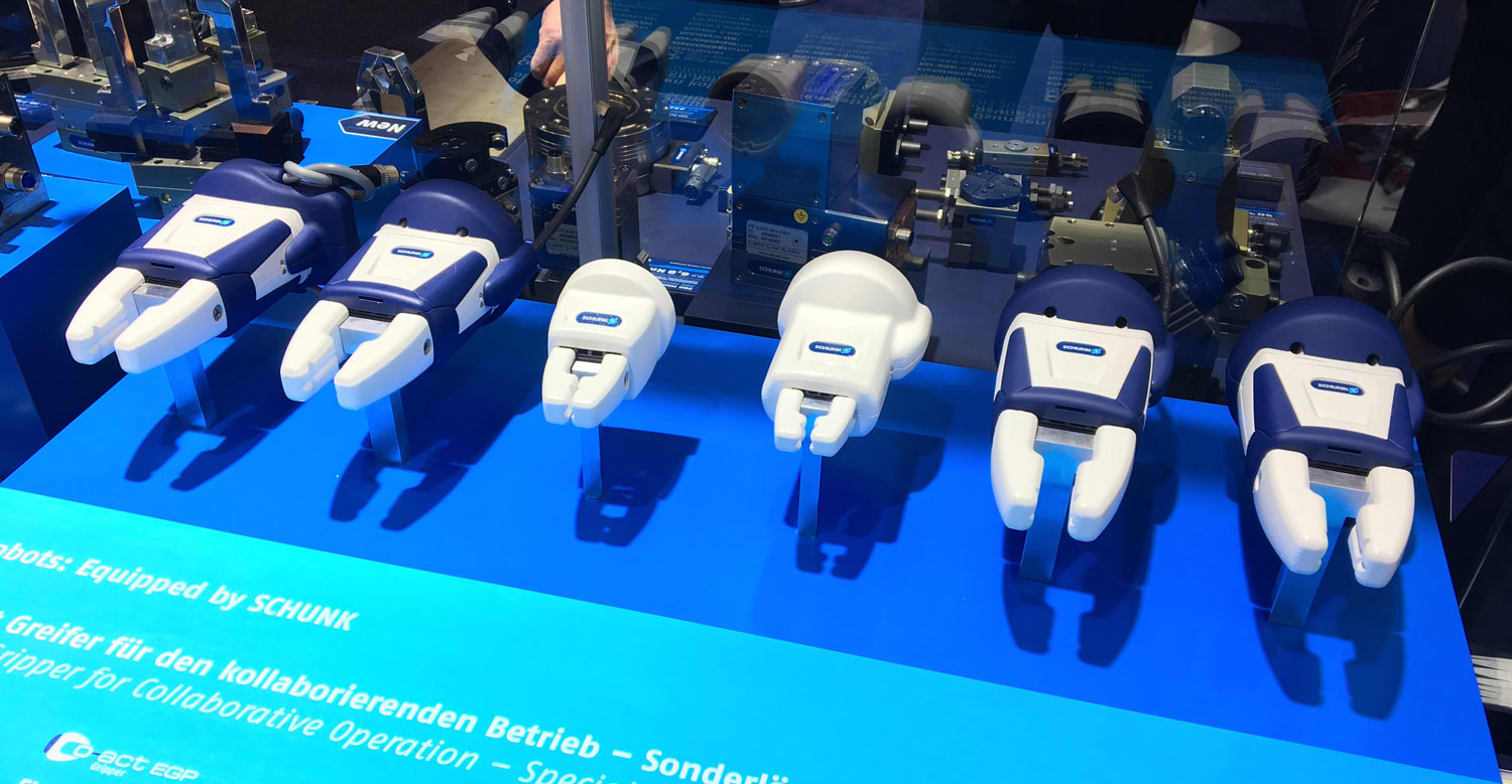

Schunk’s Safety Cobot Grippers
Cobots are designed to work with humans, and the new line of collaborative grippers from Schunk take the shared workspace one step further. These grippers operate on three principles: 1) never cause injury when gripping; 2) grippers should always detect human contact; and 3) grippers should never lose a work piece. The grippers from Schunk have built-in safety features that enable them to be used with cobots. They have force limitation settings that are activated in the presence of a human, collision protection to prevent injury, gripping force maintenance, environmental sensor systems to be able to better understand the work environment and humans, and software to evaluate and process signals from built-in sensors. Schunk grippers are compatible with major robotic arms, including those from Universal Robots, ABB, and Kuka.
